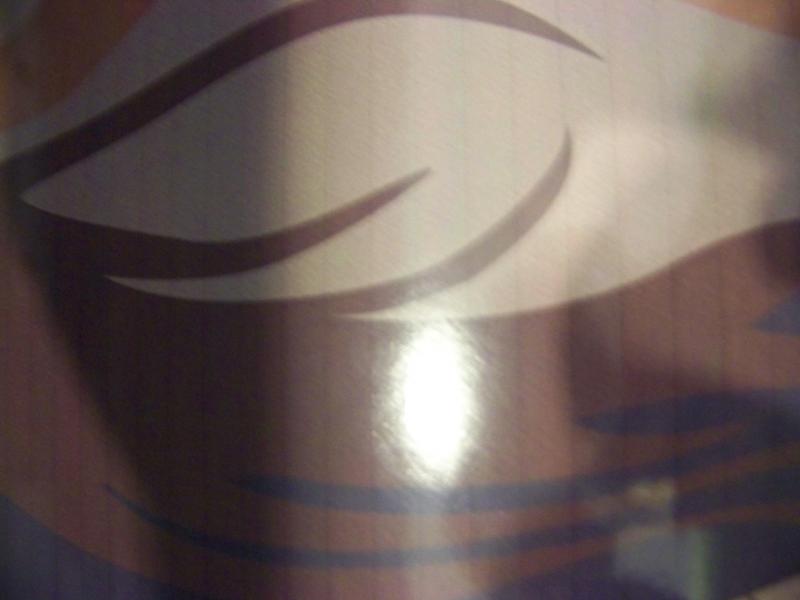

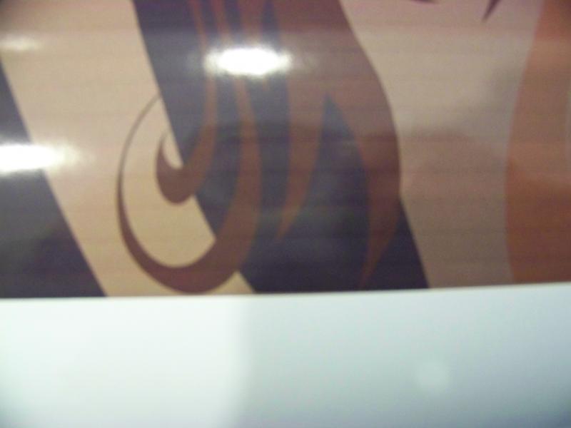

Ok...I'll send you the pics. I hope you can see it.
Kyla
Letterbox Mike
That looks like the media compensation is way off. Do you know how to adjust it? If not, while the printer is printing, hit the function key, then enter and you can adjust it on the fly. It looks like it is way too low so try increasing it by 20-30 and hit enter to see if it gets better or worse. If it gets better, keep adjusting it until the lines go away.
