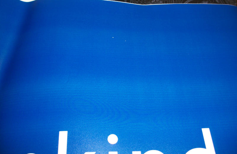

I am running a JV33 4 colour (2x each of cmyk) which last year had a problem with banding patches which came in waves (most visable on solid colours), i changed the profile i was using from a metamark 720x720 8pass unidircetional to an avery 720x1440 8pass unidirectional and got much better results but now the problem is happening again, I adjusted the heater settings which cured the problem for a while but yet again the problem came back. does anyone have any ideas whats causing it. I'm waiting to speak to an engineer but as I am away after tomorrow i dont really want to leave it to someone else to sort. I am thinking it may be the cyan dampers as its blue colours that seem to be showing the worst at the moment.
Deano1

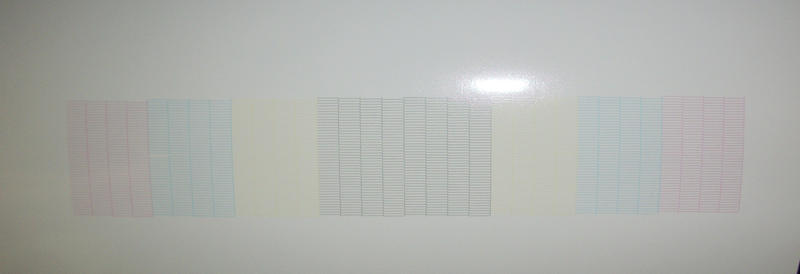

Thanks for replying, I have attached a couple of images, 1 of the print test and one of the banding problem.

I can see several problems here. Lighter and darker areas probably caused by improper storing of the media. If roll of material lays(especially under pressure) on it's side for a while it's surface changes by areas like this. If this wood like pattern is not just camera optical interference then I'm just positive that this material was stored in wrong condition and maybe accidentally got under a shower. This vertical dark traces of grit rollers say of overheating or static charges problem. And finally this pass-width banding probably caused by dampers. But I would start with replacing media with one I'm sure of.

Same as other said above it would be nice if we could get a closer picture of the passes..

Make a MediaComp test and send us close picture

The banding happens mostly when ur media is not flowing smooth,,,or ur heater temporature is not appropriate,,,,or may be the damper of the respective color got weak...

Thanks to all who replied, it turned out to be the dampers, they have been replaced and is now printing much better, still some banding but its much harder to see, I will be keeping a close eye on it.
Thanks again for everyones help.
