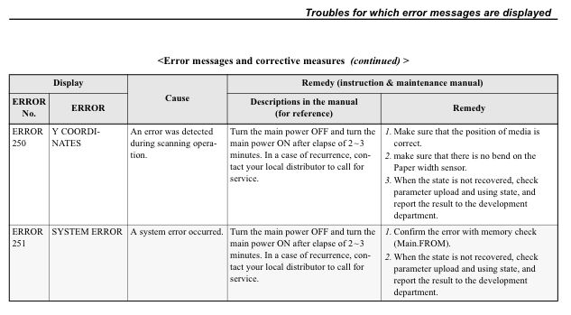

This probably doesn't help much, but here's what the service manual says about an error250.

You should reload your original parameters. Mimaki dealer can get them for you. Load them, and don't do capping alilgnments in the future unless you are very careful and know what you are doing.
