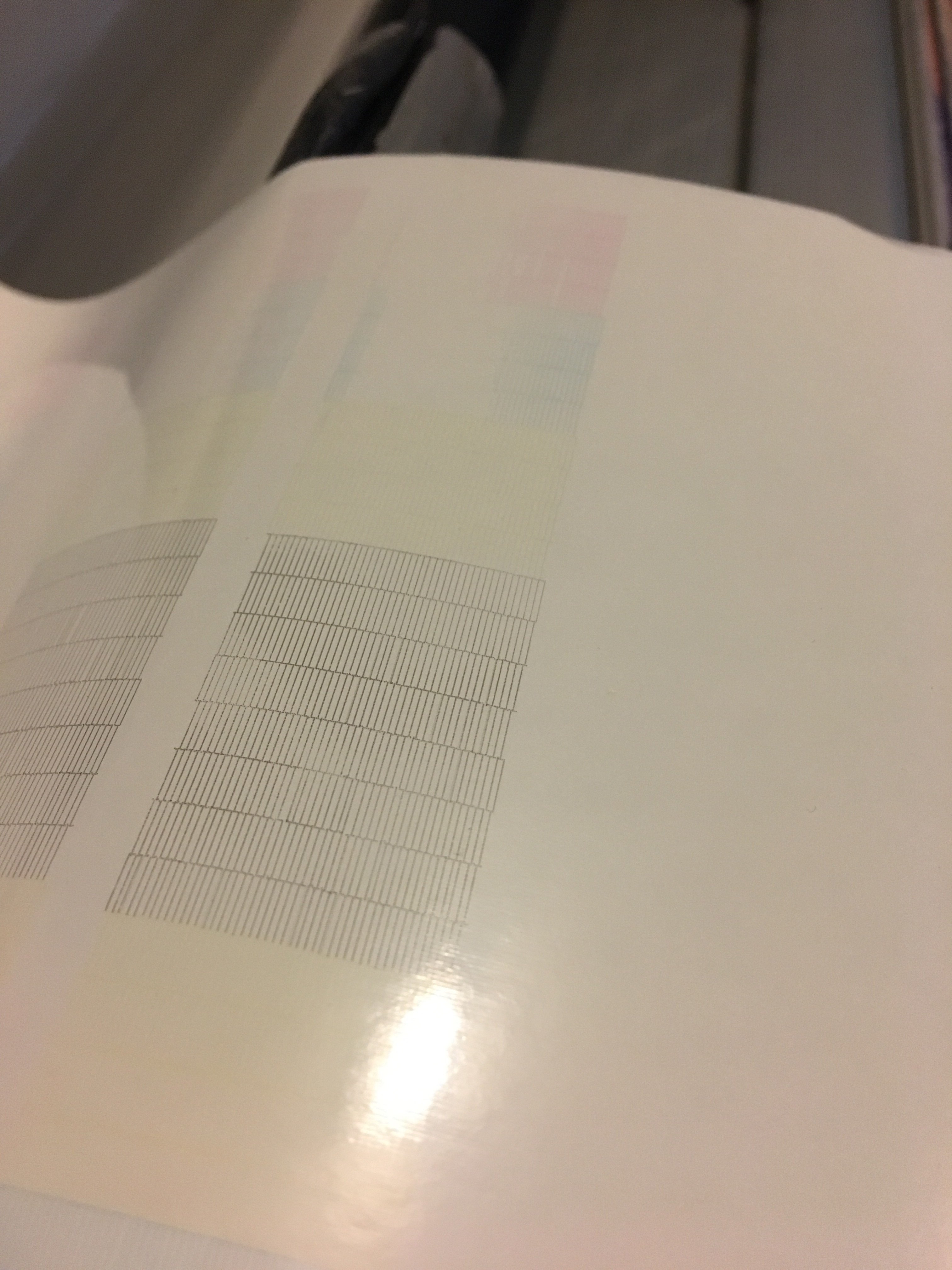

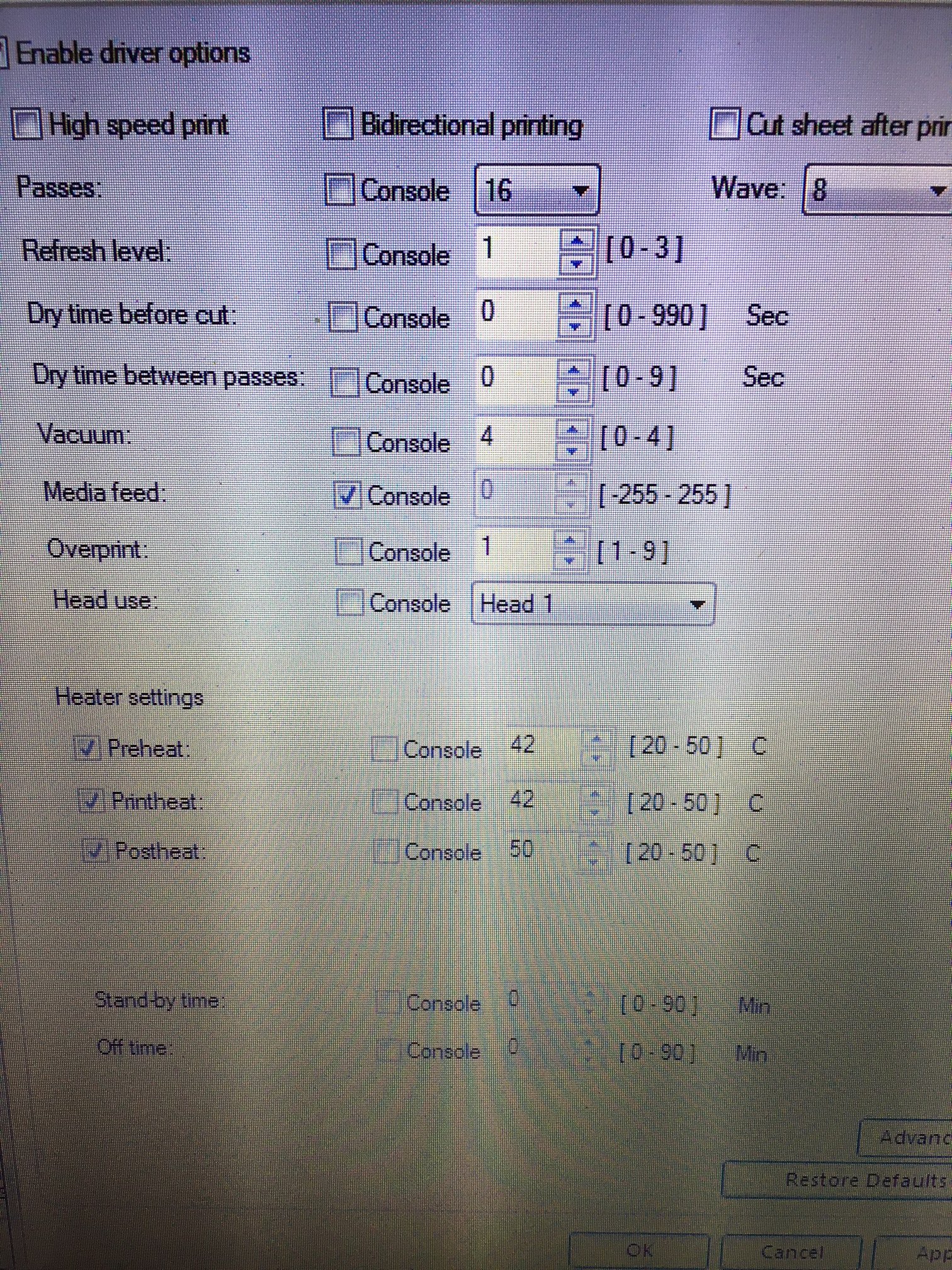

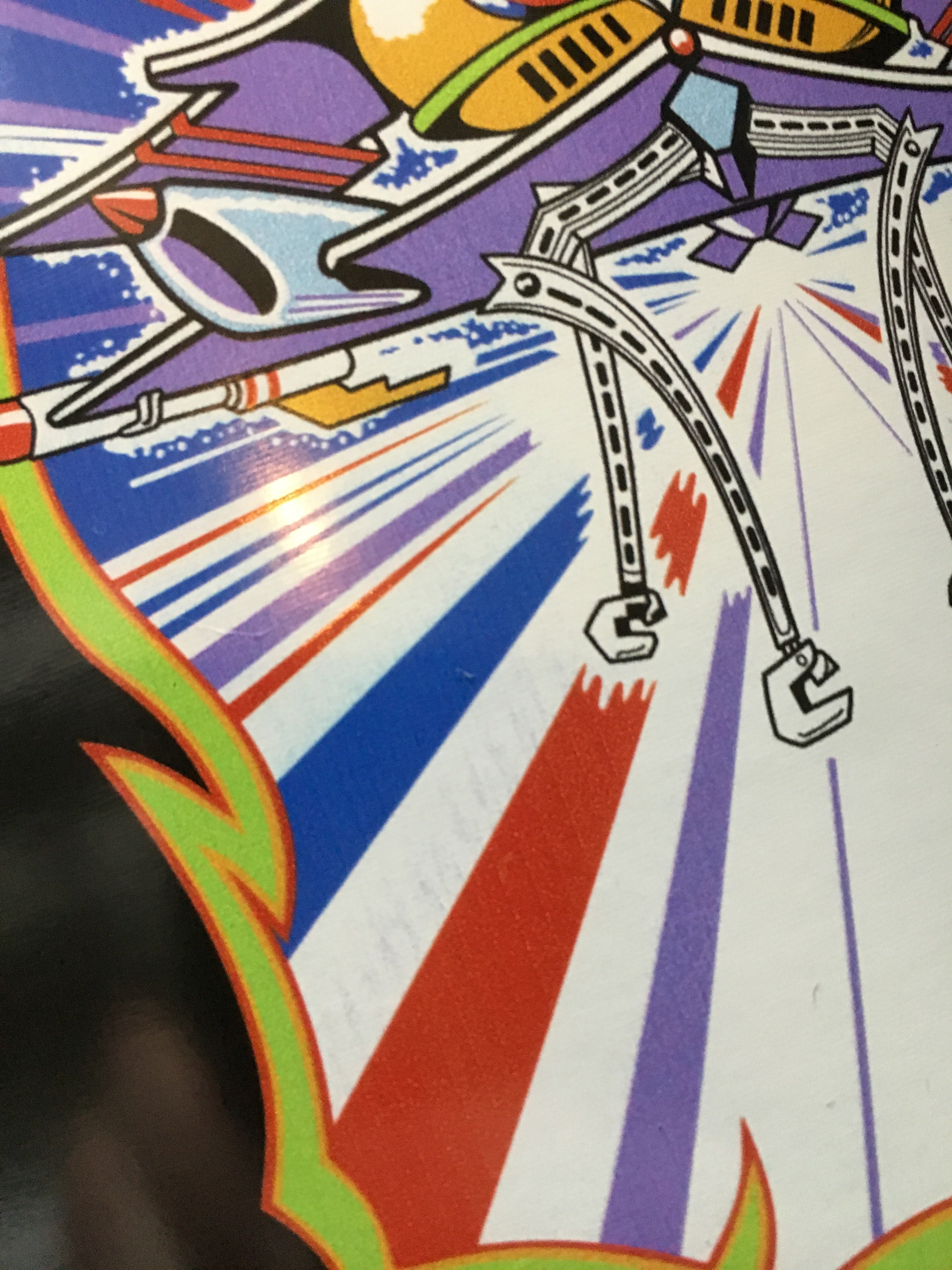

I recently purchased a mimaki jv33 that does have some missing nozzles. My question is concerning what appears to be overspray or deflection in my prints. I wondered if anyone here can perhaps help. I’m posting my settings in flexi along with a picture of my print if I can

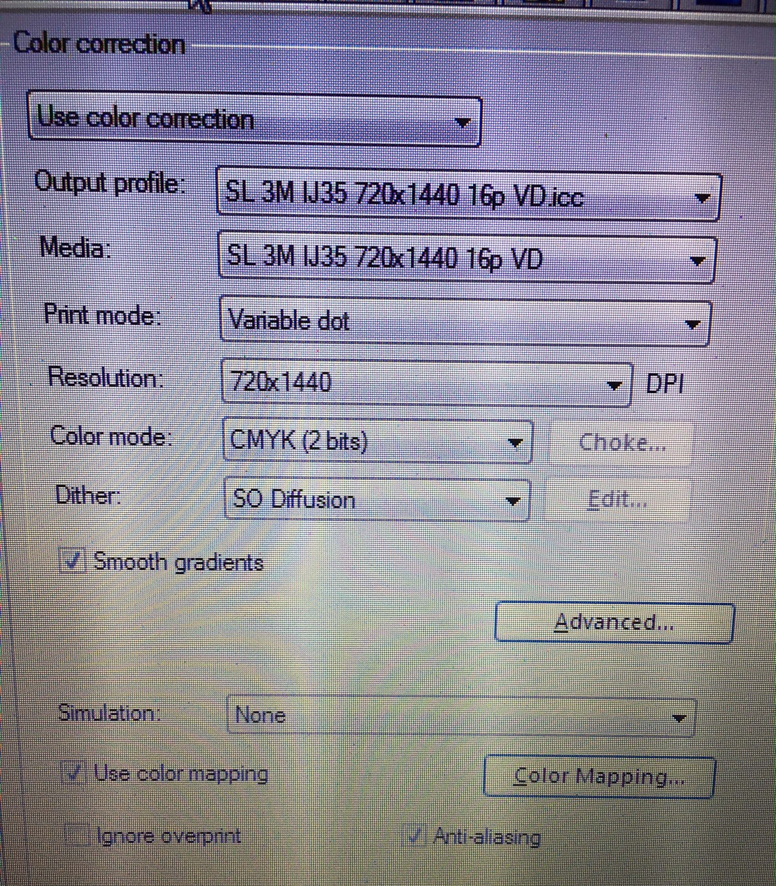

Here are my settings in flexi

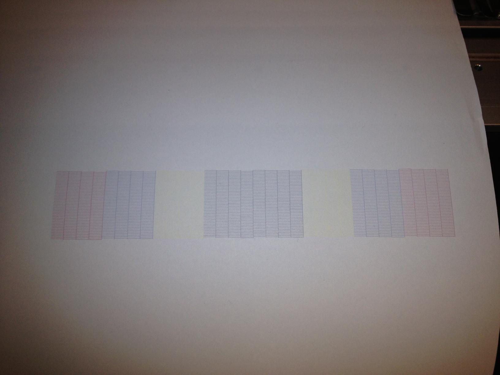

Hi! This overspray is literally a clogged nozzle problem, so, you need to unclog the cyan and magenta nozzle, if you already did a hard cleaning let the printhead soak all night with solvent and then do a Fill up ink process, you can do it multiple times if needed. Once all the nozzles are unclogged you'll have perfect prints and this overspray will be gone.
Attached a picture of how you're nozzles should be.
Thank you for the reply. I realize the test should look like that but the previous owner said they had a head strike and it is not a clog. So is the overspray something I cannot get rid of now without a new head?
RogerZ
Unfortunately no, if the printhead has a strike on the nozzle this overspray will continue cause' it's damaged, your print settings are ok, but the overspray it's cause by the missing nozzles.

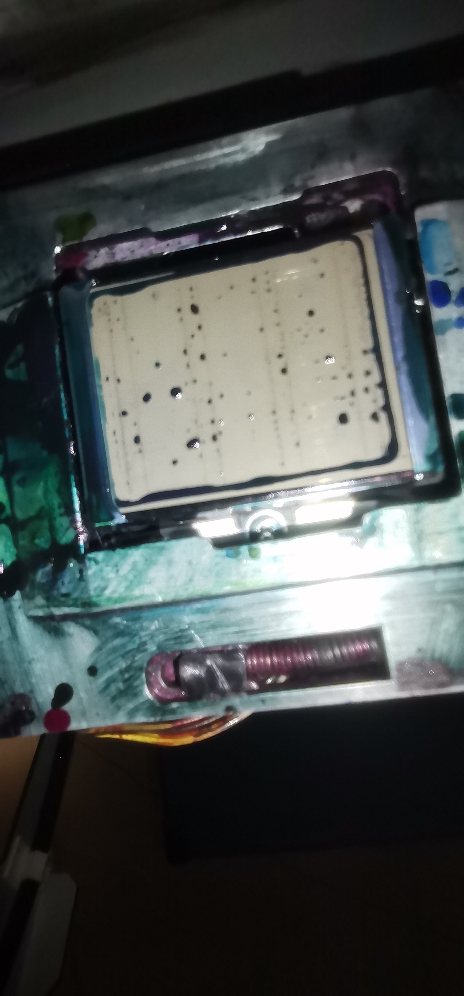

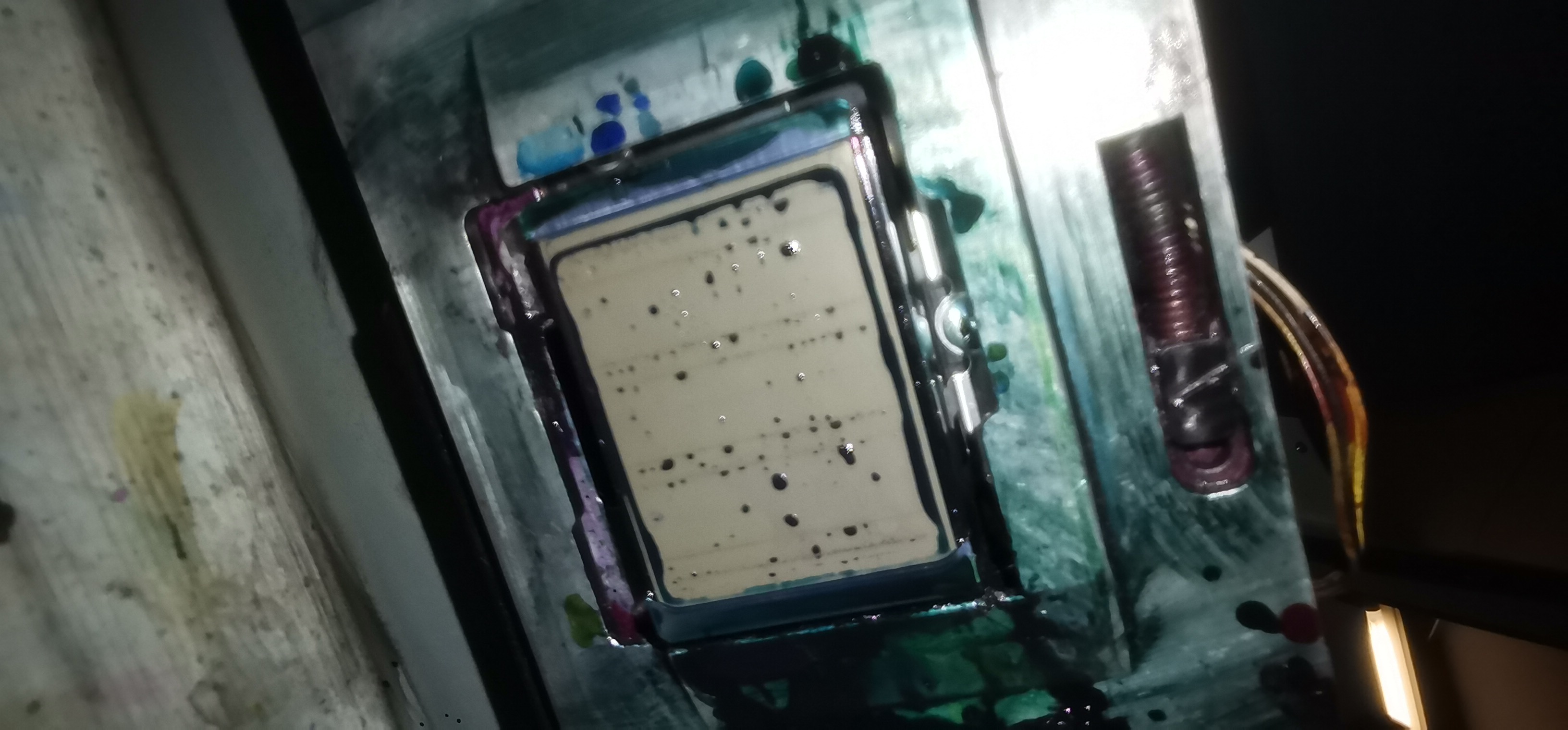

Mimaki jv33. New print head 2weeks old. New slider. Main board. New hdc fpc cables. New head cables. Dampers. Captop. Pump.
Printing worked fine.. For 2 weeks..
All of sudden magenta dropped on both sides.
Done numerous head soaks.
Pulled ink through from below camping. Ink fill ups.
Magenta still nit showing. If it does it's just few nozzles the. Disappears. Swapped cyan dampers and ink line to magenta and vice versa.. Magenta prints on cyan. Cyan missing on magenta nozzles.
Please can someone help. Please. Attached pic of cap top and head.

Pregasen
Also what I noticed. After a hard clean. Magenta still no show on test draw.. But can see the left damper towards media fill up. Right damper towards keypad does not fill or does so very little. Test draw no magenta. If I pull th magenta dampers off and place back. Test draw fill 100percent nozzles. But drops when printing.
