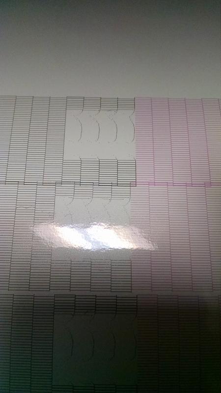

As you can see in the attached photo the black head isnt printing right. The problem started when the black pump assembly broke. I replaced it, tried multiple cleanings, but no difference. Any advice?

Good news! After you replace that black head your prints will be perfect again!
Bad news - I think that is a fatal problem I see...

assuming no major head-strikes recently.... you've definitely got gummed-up printhead.

yes. at least I'd start there before diving-into head replacement right away.
clean everything, set nozzle-wash (99min), power-down & unplug machine from wall (this bypasses machines automatic cleaning cycle, and allows heads to keep soaking indefinitely in the solution you filled capping station with.
also, do you have foam-swabs? completely saturate a foam swab with cleaning solution and give the printhead a single-wipe in the direction the wiper normally makes contact with the printhead. gently, and do not scrub or reuse the same swab for multiple wipes. this will pickup anything else that simply soaking could not break-down. run another quick nozzle-wash after this, and even a fill-up-ink on the black printhead (to cycle fresh ink into the printhead) and post your newly recovered test print.
i'd bet $$$ that you'll have recovered at least 80% of your nozzles, and all you have to do is repeat until it is fully cleared-up. (assuming you were printing at 100% prior to this issue)

if none of the mentioned procedures works,,,then better do one thing,,
you cab swap the print head with the nearest one & give a FILLUP,,,a cleaning too..
then go for a tst draw,,,if the problem changes the position thn its better to change that particular print head,, bcoz i belive it hav physical damage with the nozzles which is very dificult to see with ur bare eyes,,,,all the very best,,thnx :)
