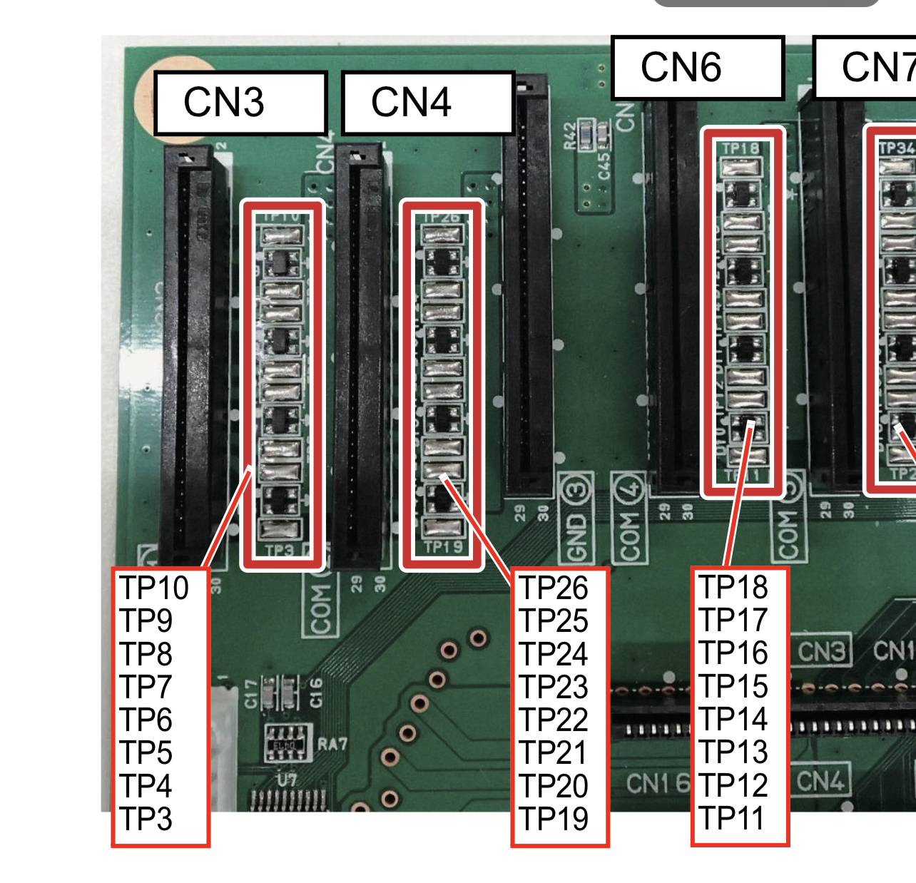

In cases like this where it appears the problem is electrical I would check for head damage using a voltage meter.
You can check the TP points of CN3 & CN4 of the slider board for abnormal resistance. Each silver contact point should read pretty much the same. This will most likely confirm that you need to replace the print head.
(Touch each Test point with the positive end of the voltage meter. Make sure the negative side is grounded or touching a part of the metal frame if the printer)

gave me a system 187 fault when i came in this morning.. I cut off and cut back on now it wont boot up it stops
Impact1
Wide Format Technical Solutions
Now your slider board is damaged. Most likely because of the head. Your going to need to run or have someone run the resistance test from my last post to confirm this. But, it looking like a head & a slider board.
