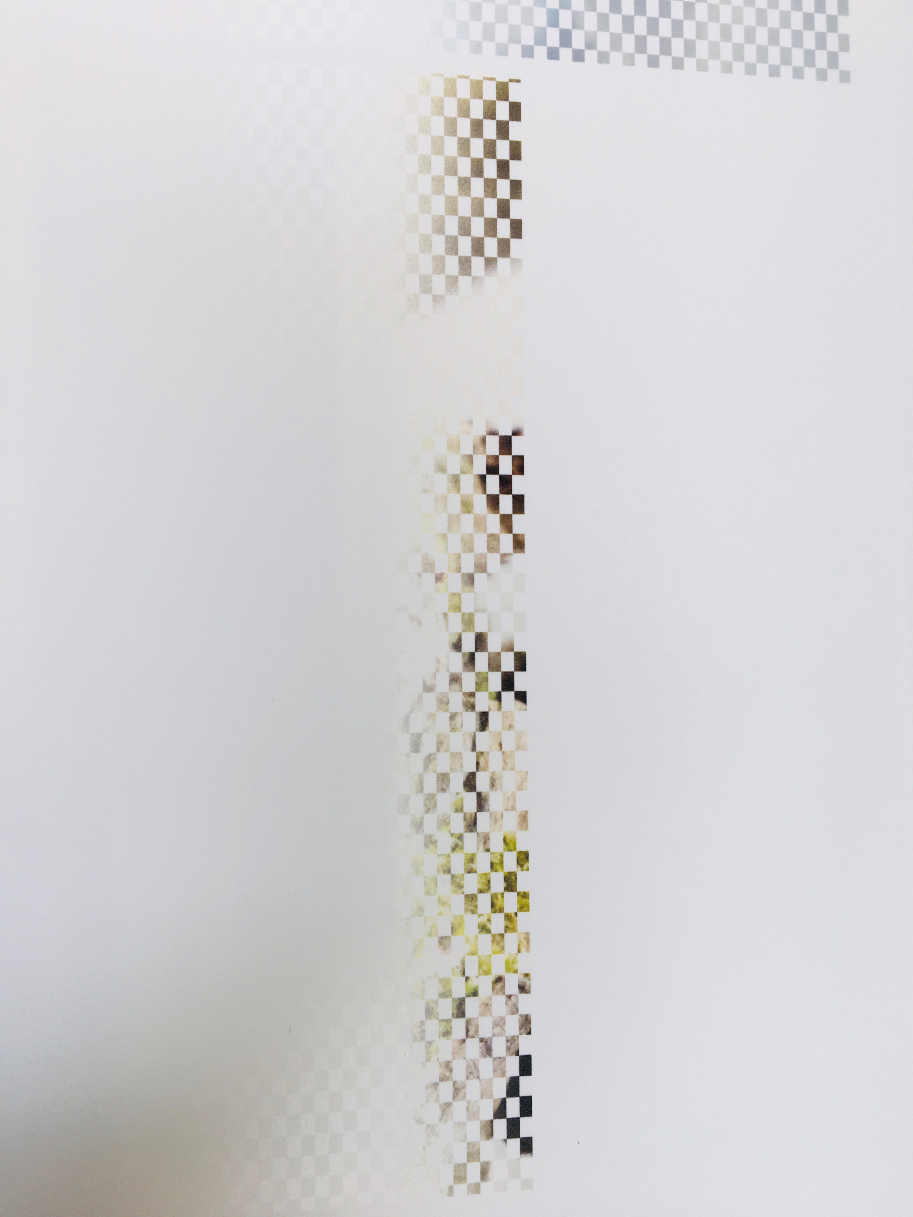

Anyone come across this issue while using a Mimaki JFX200-2513
Printing on Foamex.
Seems like a very rare issue any help would be apprecaited.

Might be a problem with the file itself. It has the look of a transparency layer. Maybe check your layers to be sure something like that is not going on.
Davyd Ryalls
jwlllpl,
Thanks for your reply.
I have managed to fix it all I needed to do was update the software:doh: which was easy for once, I did wonder whether it was to do with the file or maybe a network issue.
