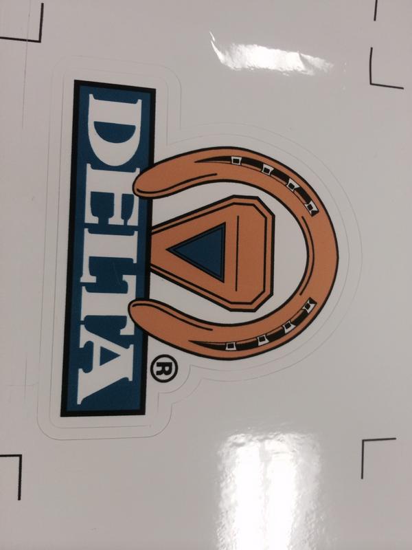

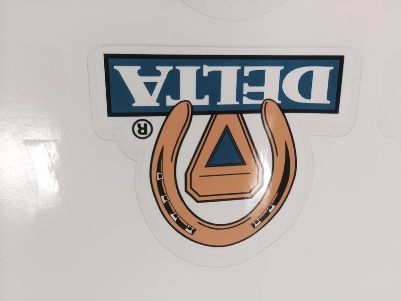

Hey all.
I am printing labels and the customer wants them Contour cut as well as Half cut allowing for a 1/8 or so border.
I cant seem to get the Half cut to stay in registration. More so it stretches in regard to position as it gets farther from the origin in the Y axis.
I have tried as few a 6 up and they are still unacceptable as they get farther from the origin.
Let me be clear that the contour cut is very acceptable. It is only the Half cut that seems affected.
When I allow for registration marks for every copy then there is no problem except the fact that I have 1000 each of 5 to make and the constantly finding marks and wasted paper is killing me.
I am using a Mimaki cutter with Flexi 11 on nonlaminated adhesive vinyl.
THANKS!!
Pics attached.

You do know you have to move your blade to the front of the blade holder to do halfcuts, you can skip the contour cut and just do the halfcut just that there won't be no bare backing showing.
Leebee
Yes I do know this. As a matter of fact Sai made a patch/update for me to fix a bug relating to the switching to half cut as a second cut in Flexi11.
It's purely a registration issue when doing more than a couple stickers/labels without adding targets to every piece.
