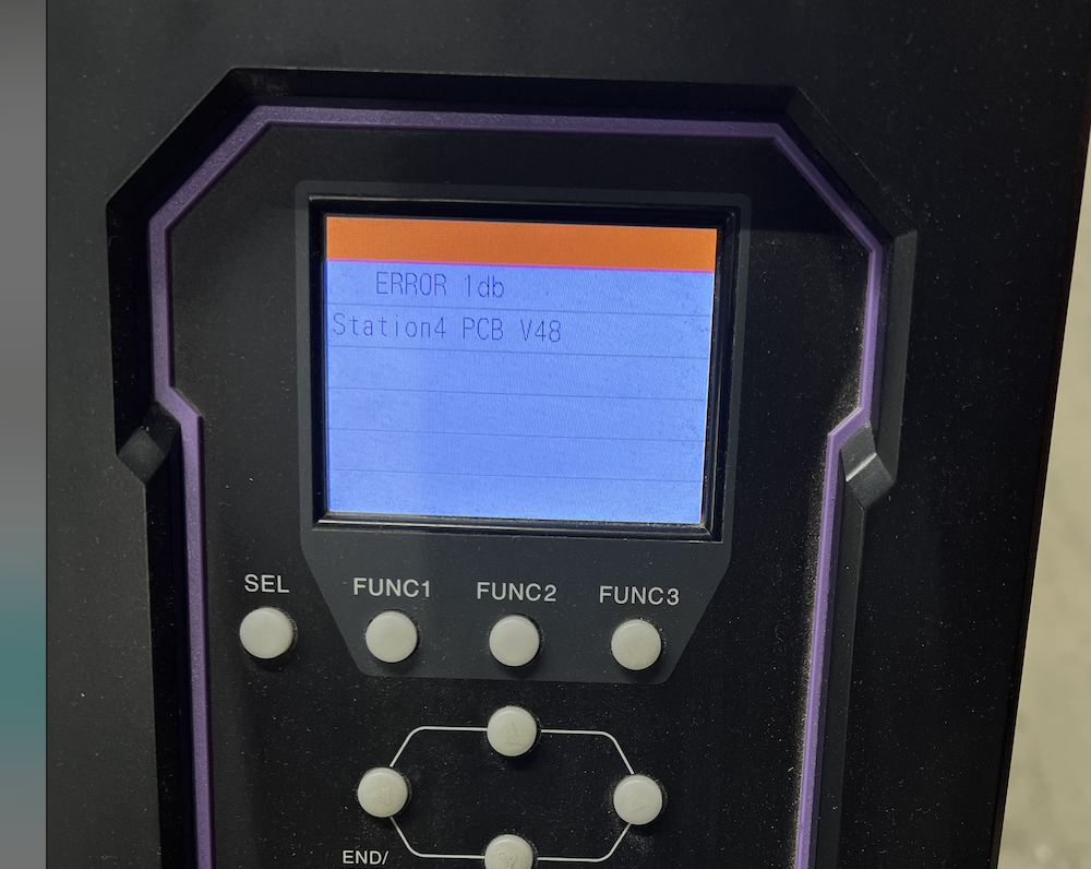

- I purchased a used ucjv300 as our first uv printer. When its powered up, it displays "Error 1db" "Station IV PCB V48"

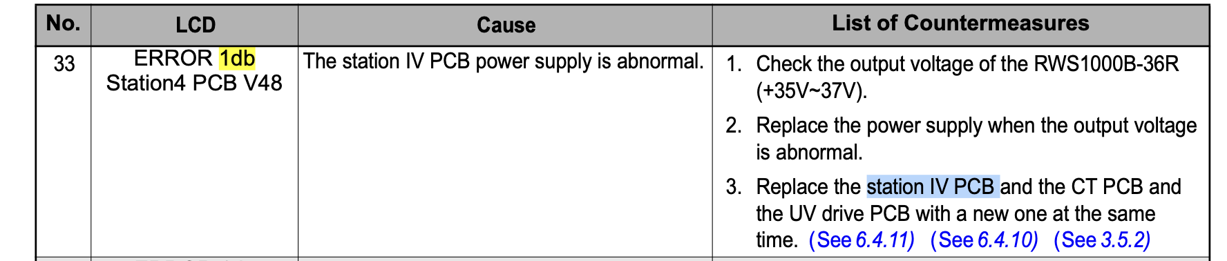

- Looking this up in the mainatnce manual; it says - check and replace the power supply, and then an additional step, notes to replace 3 PCB boards.
- For background: The previous owner said they used the machine lightly, and then stopped using it about 14-18 months ago. The last effort to run print test on the head several months ago led to this happening..
My question is if any of you have had this "error 1db" and know what can cause it, and how you were able to resolve it?
- It seems odd that a significant amount of boards all failed at once
- Does the maintenance manual entry ( attached) mean that both the power supply and the boards all need to be replaced, or each of these steps normally independent, one or the other?

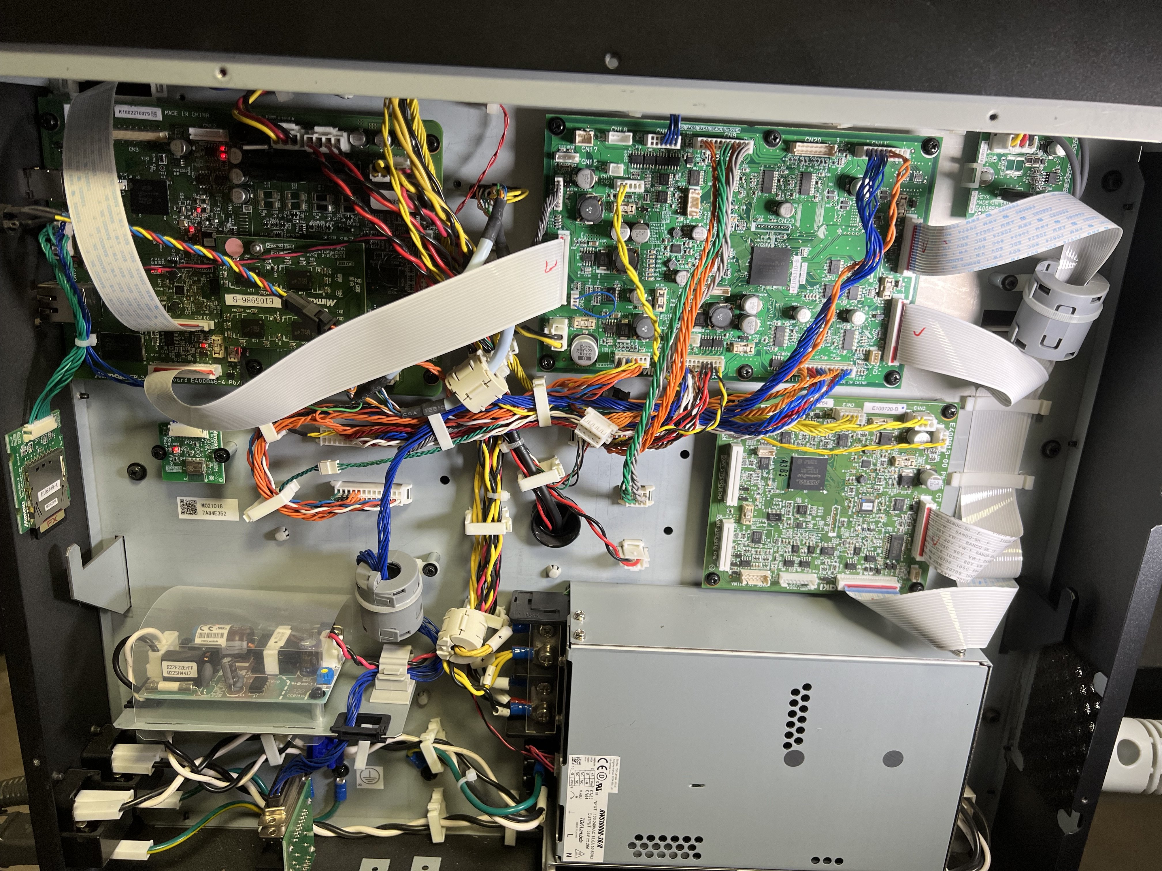

- I powered it up, it displayed the Mimaki logo with boot up for a little while, and then went to the error screen with the 1db error.
- The entire time, the power supply fan ran at what seemed like a high speed. But I am not familiar with the normal operating sound of this so not sure if that is normal, or if the PS varies it's fan speed as needed.
- I checked the voltage across the output terminals on the power supply in the back, and it measured 35.92V. Does this mean the power supply is not the issue? Or are there additional measurements / tests I should do with the power supply?
- Looking at the various PCB's in the back cabinet, I noticed that the main PCB on the left, had a number of red LED's lit up. (see photo), However no lights on the station IV PCB, or the CT PCB below it.
- I then opened up the top panel as well on the back to access the UV Drive PCB. It also had no LED's lit up, and the small fan next to it on the right was off. The area around that fan, and about 1/3 of the UV PCB was covered in dust pulled in by the fan
- With power off, I tired to carefully clean up the UV PCB
- I check the fuses on the stations IV PCB, and on the bottom of the UV PCB for continuity ( while leaving them installed on the boards) . All beeped on my tester and seemed to be ok
- I then tested the boot up again, same boot screen, followed by error 1db
- No lights on the 3 boards ( Station IV PCB, CT PCB, UV Drive PCB)
- I'll attach some photos
- Are there other tests I can perform, or isolate certain boards to see if errors change, etc.
Thank you !
Smoke_Jaguar
Voltage is fine, might be a bad board or fuse. Note that some boards have fuses on both sides and they might not be referenced in the service manual.

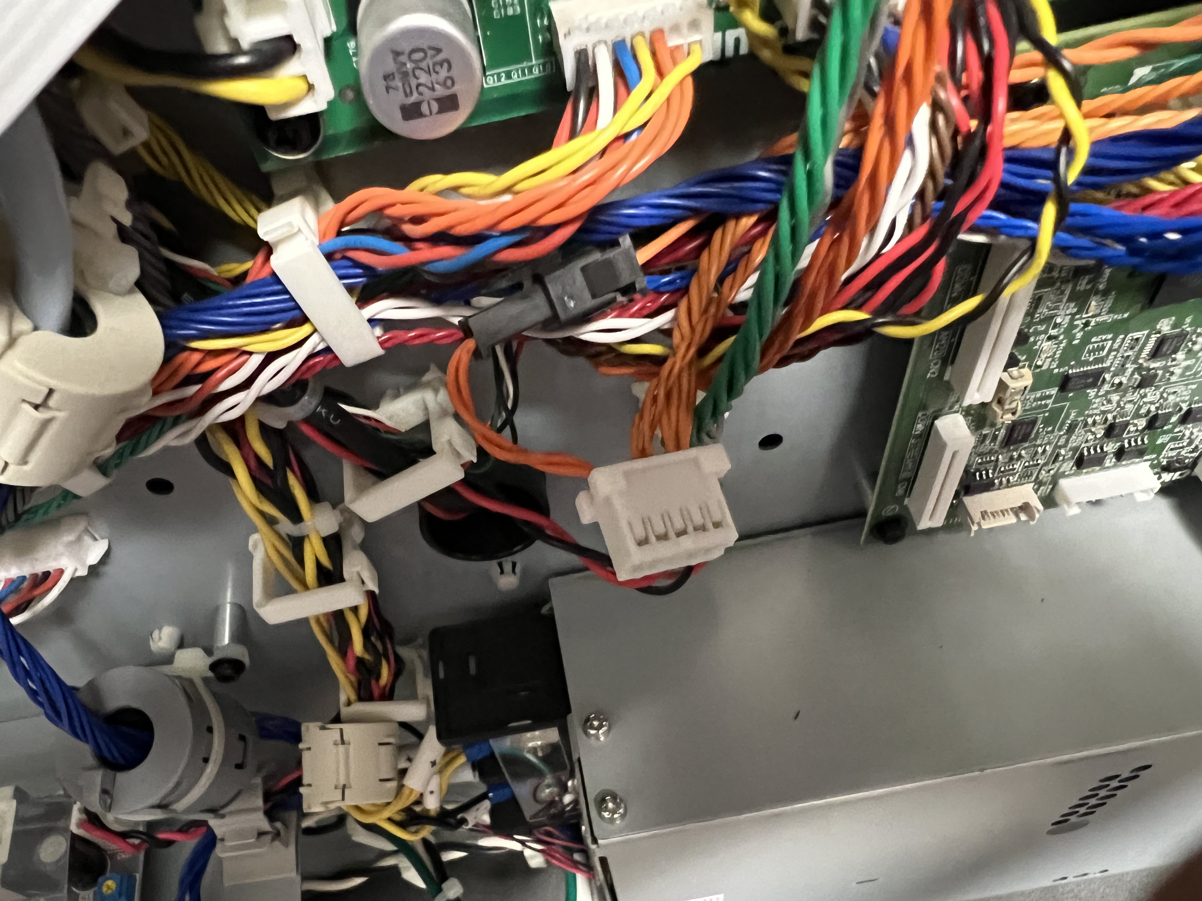

There is also this orange connector that is not connected to anything. Is that normal?
- Can you recommend any techniques or tests I can do for narrowing down which board it may be, or do you think I will have to replace all 3 together as per the service manual.
- Is there a way to boot the machine into some type of service mode where it possibly gets further before getting hung on this error?
Smoke_Jaguar
There will be a good dozen or so connectors not used in the printer, this is normal. Used for optional items, or items removed due to revisions, etc.

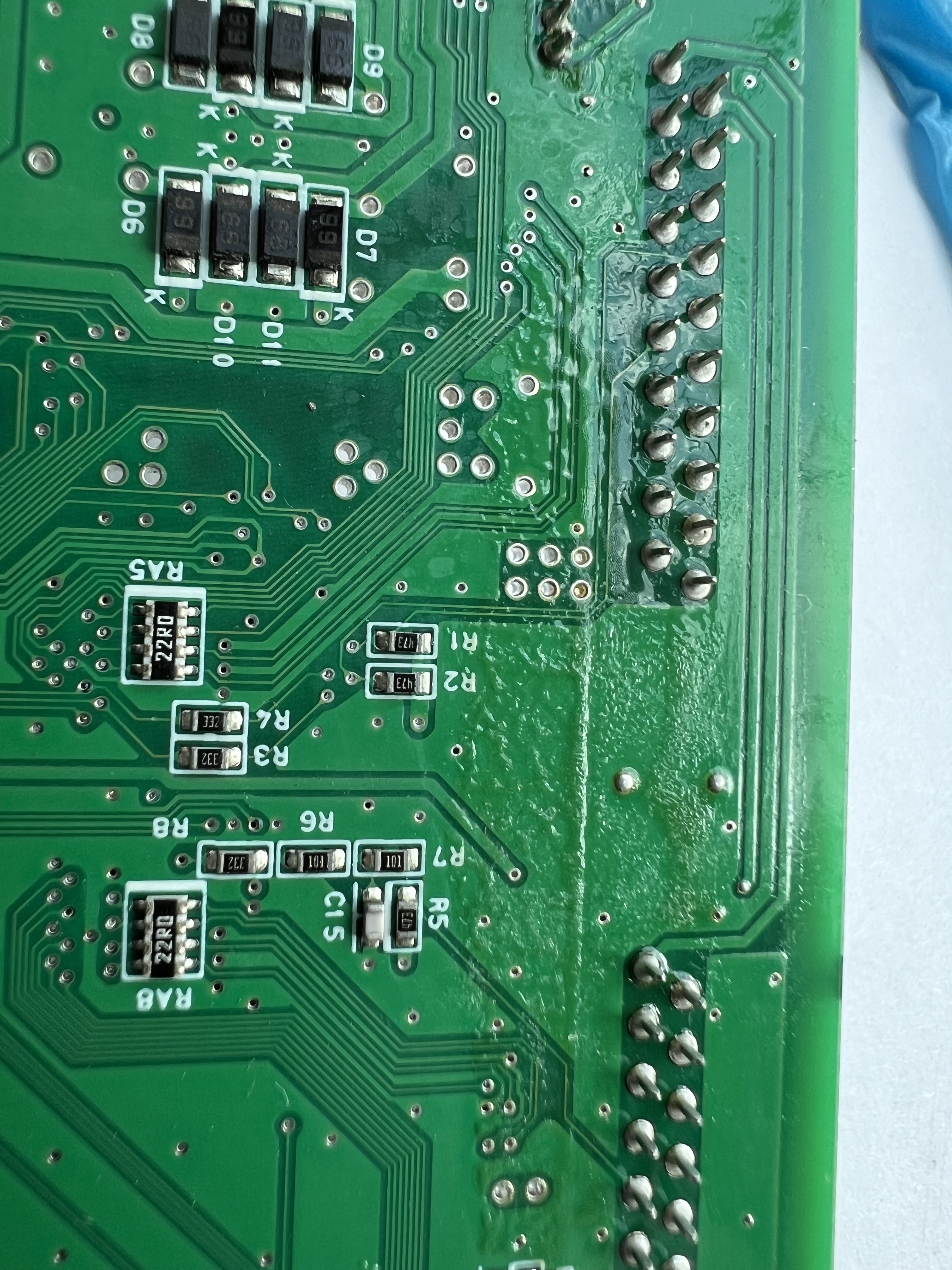

I pulled out the Station IV PCB completely to be able to take closer look and check back side. Attached are some photos of an area along the right under-side where CN2 and CN5 FFC cables connect. There is some subtle discoloration and distortion visible. I can't make out what it is yet, almost like a clear coating that has yellowed slightly; something that was just on the surface. Have you seen anything like that? I angled the board into the light to make the distortion look more obvious in photos, so it looks more exaggerated. But in reality, it is very subtle, and the circuit traces underneath look intact.
Smoke_Jaguar
Just looks like solder flux from board manufacturing, might just be a bad board. Going through chip-by-chip troubleshooting is something I don't have the patience to do remotely.
