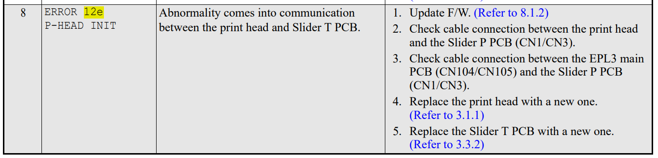

Best bet is look for connector issues, see if the cable is snugly fit and squared in its connector. The connections can be quite stiff, so can bend the flex cable or even snap conductors. That said, error conditions from service manual attached.
