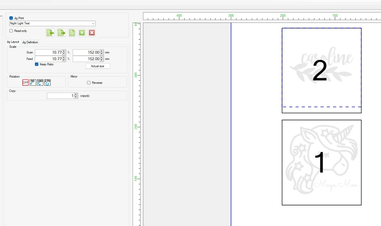

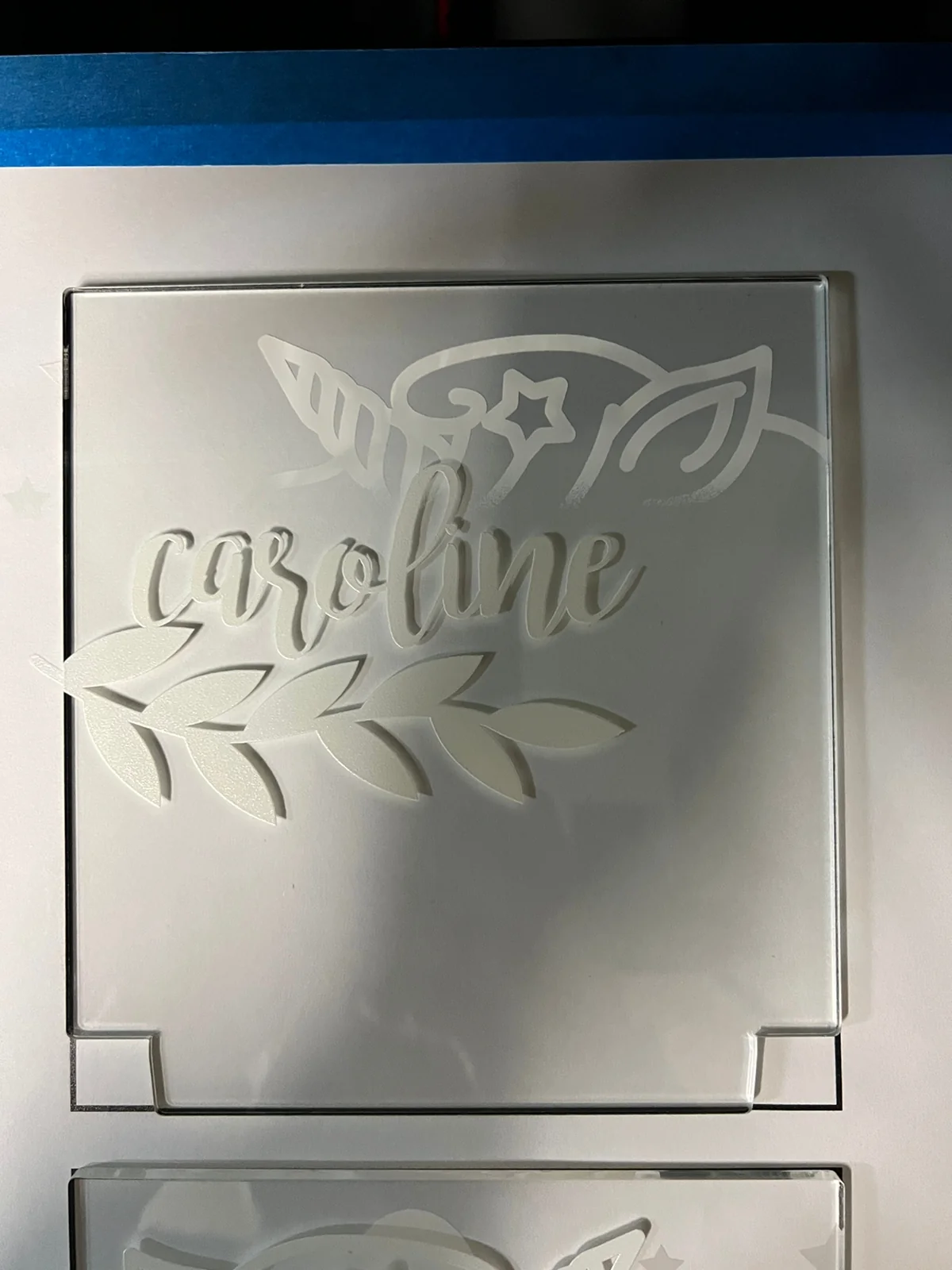

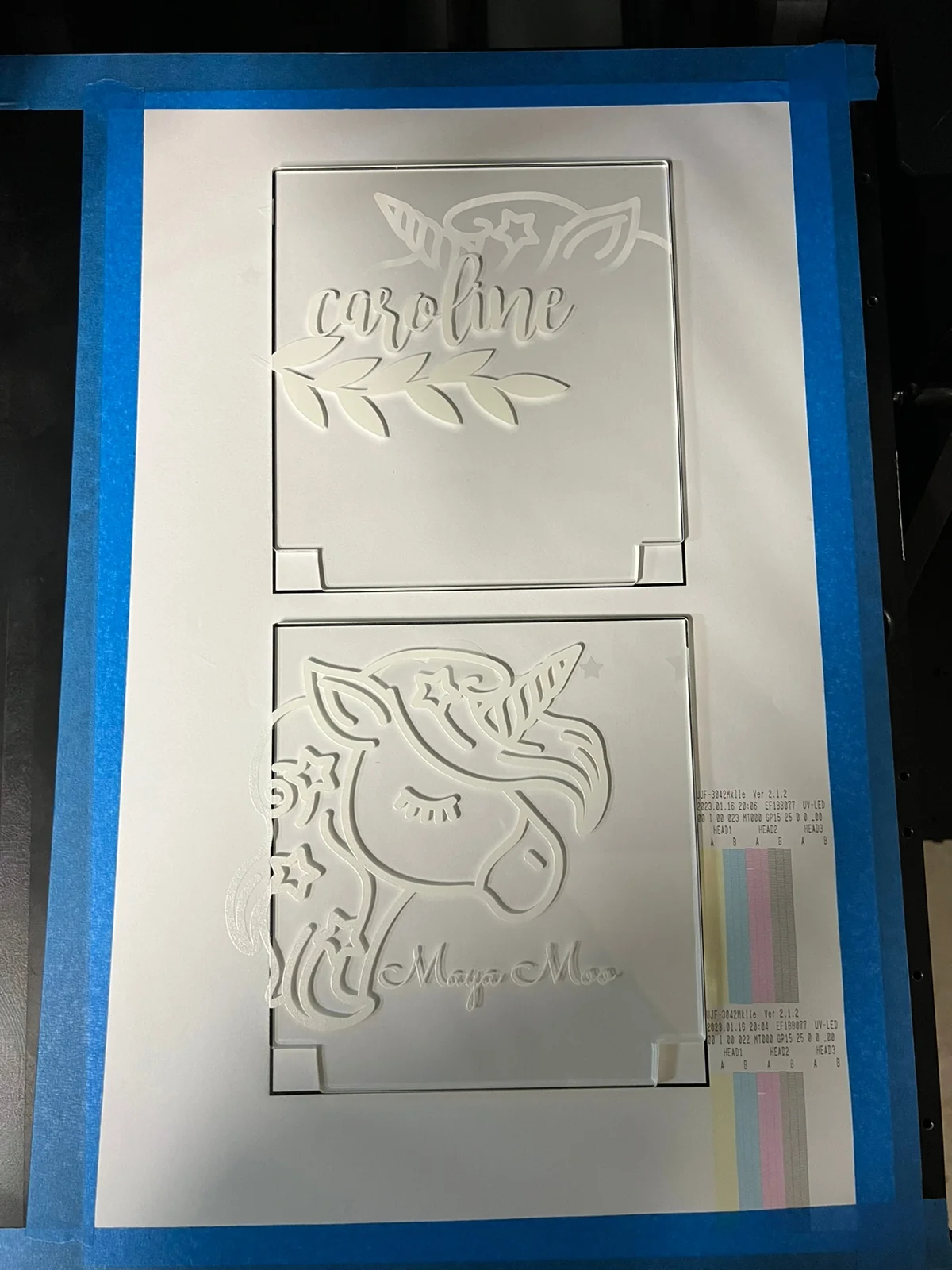

I've been printing all day and randomly about a good 2 hours ago the print position ends up printing in the wrong position, I didn't update or change the origins. All settings look good. Origins X&Y at 0. Jig templates haven't been changed either. This is the first time it ever happen. I've tried printing on other products, different jig templates and they are having the same problem. I have the latest version of RasterLink 2.8v. I've been getting alot of electric zaps when i touch the machine. I'm wondering if the static is strong enough to move the print position
trying out different things:
  1. so it ends up printing in the correct position when its just one product using the jig.
    but if you add two products to print , it doesnt print in the correct position. its really weird
  2. I've tested different products and theres no problems printing on faux leather. All the other products are having problems with print position: golf balls, acrylic screens, and metal cards.
