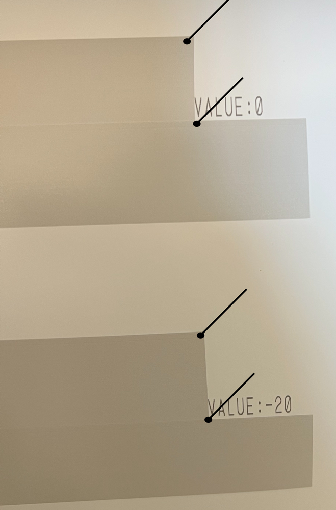

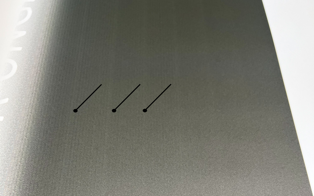

Having problems with Maimaki UCJV300. Detected stripes on print, and white stripe every 4cm. Have cleaned everything that can be cleaned, and checked all settings, tested several types of media, but did not solve the problem ... Anyone who has encountered the same problem?

You’ll never find the problem looking at media compensation test. Do nozzle test, and use nozzle recovery option if not many nozzles missing
