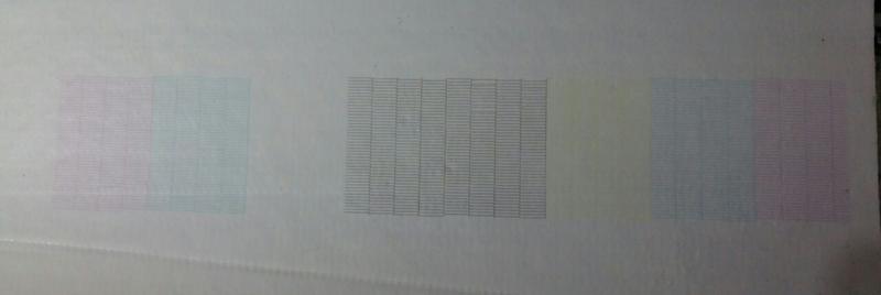

I have CJV30-160 and during printing the color of design changed so I stopped printing
then I made a test print and the yellow from one side is missing as attached
I tried soft,normal,hard cleaning with no result and tried filling for 5 times and no result too
and changed the two dambers of yellow but it not get back
any help ?

I tried nozzle wash many times but no result.
is this problem for print head or cables or what ?
noted that print head was changed from 6 monthes.

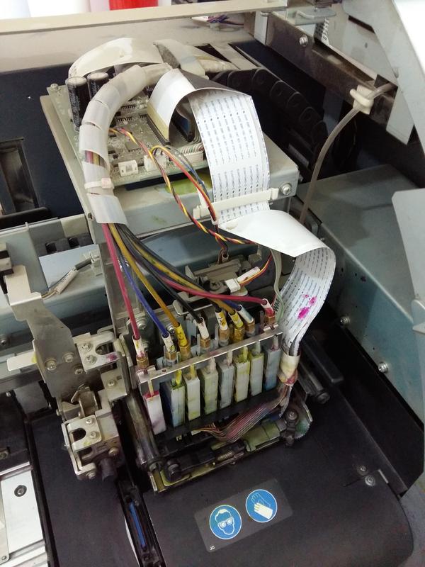

That's one of the dirtiest print head areas I have ever seen. There could be ink on the head cables but usually that wouldn't affect only one channel. The first thing you need to due is use air duster to clean the slider board and cable terminals. Then take the dampers off and check the manifold for any damage. If the manifold is intact, change the yellow dampers, damper clamp and o-rings. If that doesn't fix your issue, there could be damage to the ink lines somewhere or a bad connect anywhere ink line connects to something. Other than that, based on the amount of debris, dust and ink in the head picture, there could be an electrical short somewhere that caused damage to the head or main board.
