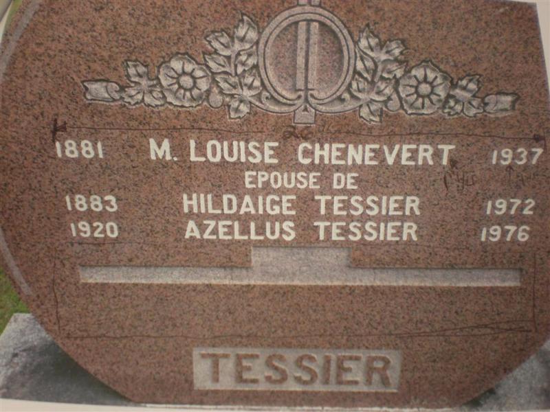

I have a special request from local tombstone maker. Does anyone knows the closest match font for this? I have few small signs to do but don't have anything other than Arial condensed... and it's far from what I need.

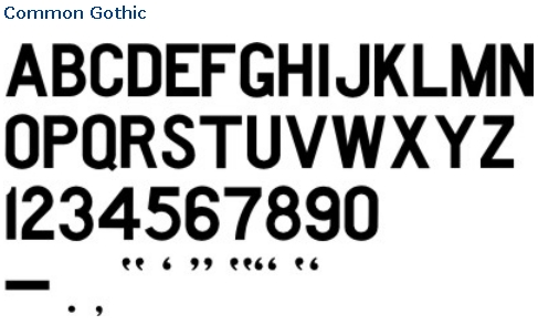

Well, after extensive researches, I've found exactly what I need: the font is called COMMON GOTHIC
The only problem is availability. Seems like I could only buy it from the makers of softwares for monuments engraving or Gerber's monument fonts database.

As you can see on the pic in 1 post, there's a shape engraved under the last name but we have another name / date to add. The family wants the last name with the 3 others, not under the shape. I don't know the reason and the rest of the story but that's what I had as explanations...

any omega past 2.5 should have it as MON STD COMMON GOTHIC AK REV A.
Yep...that's what I was going to say. I can't share the font, but if you want I can type the alphabet and convert to curves so you can "piece" it together...it sure beats tracing. If you know how to use a font editor, you can make your own from the file.
We also do date cutting / monument work and I've had to do a few this way. Just pm me your email address and your preferred format (ai, eps, .dxf, .plt).

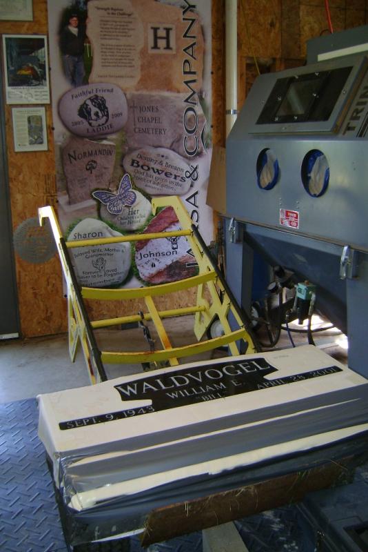

....On another note, we're also doing something similar today. This jet black slant marker was purchased by a customer at a salvage yard for 50 cents a pound. His brother (the deceased) was a recycler, and he wanted to honor him with something that was "recycled". The exposed granite in this photo will be recessed back about 1/4" deep for new text.

Thanks for your offer but job's done already. After I found the font, I zoom it at the max just before loosing too much details (blurry) so after importing it into Flexi, it has been converted in a snap. Tweaking few corners here and there... voilà!
I always prefer using actual fonts whenever it's possible but I've learned it the hard way starting my business 25 years ago so I know how to do things manually. My 1st computer didn't have color monitor, scanner and fancy printer... Now it's easy with new softwares and all connected options (tablet, scanner...). The 1st time I used a real sign design software (CasMate), the "scan-to-vector" button put a smile on my face on a daily base!!! No more point-by-point vectorizing on the Summa tracing tablet.
At like $39 for the font, I wouldn't had lost my time doing convertion but at $100, I think I still saved few bucks...
