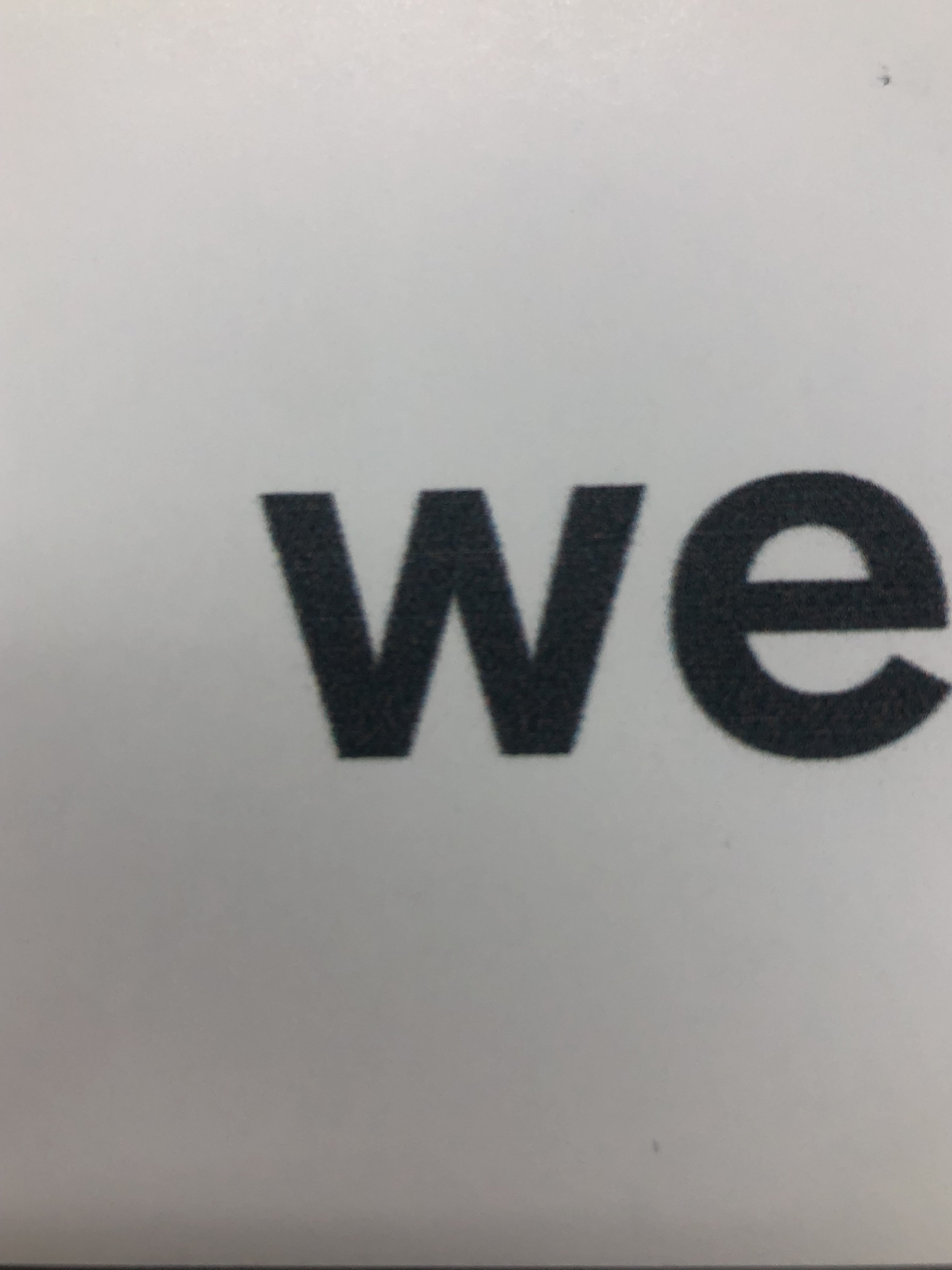

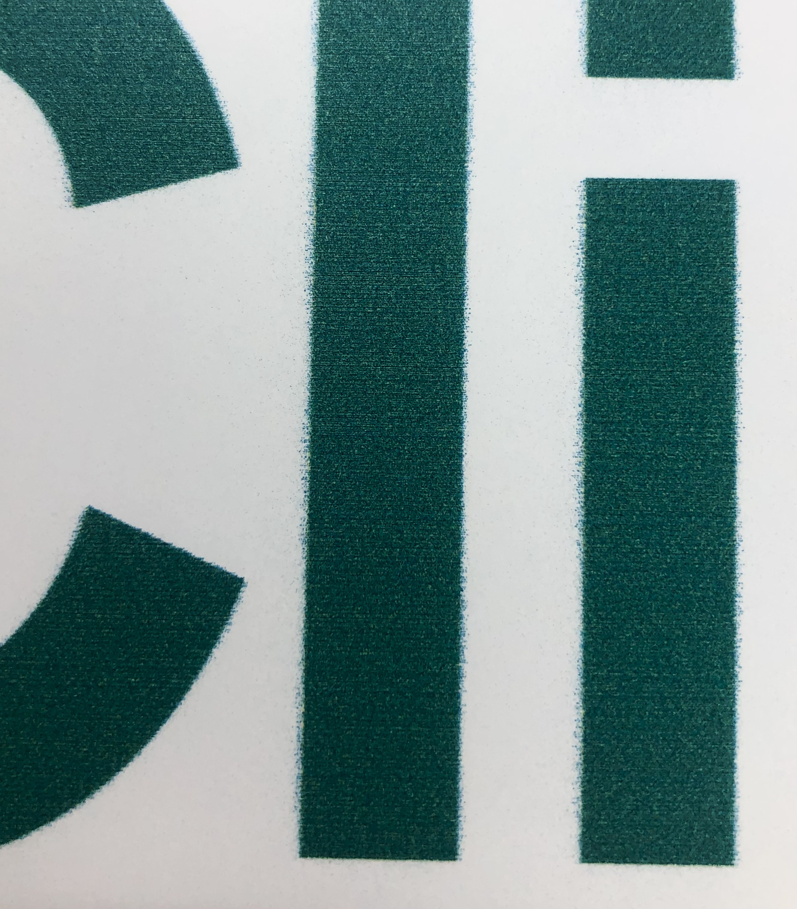

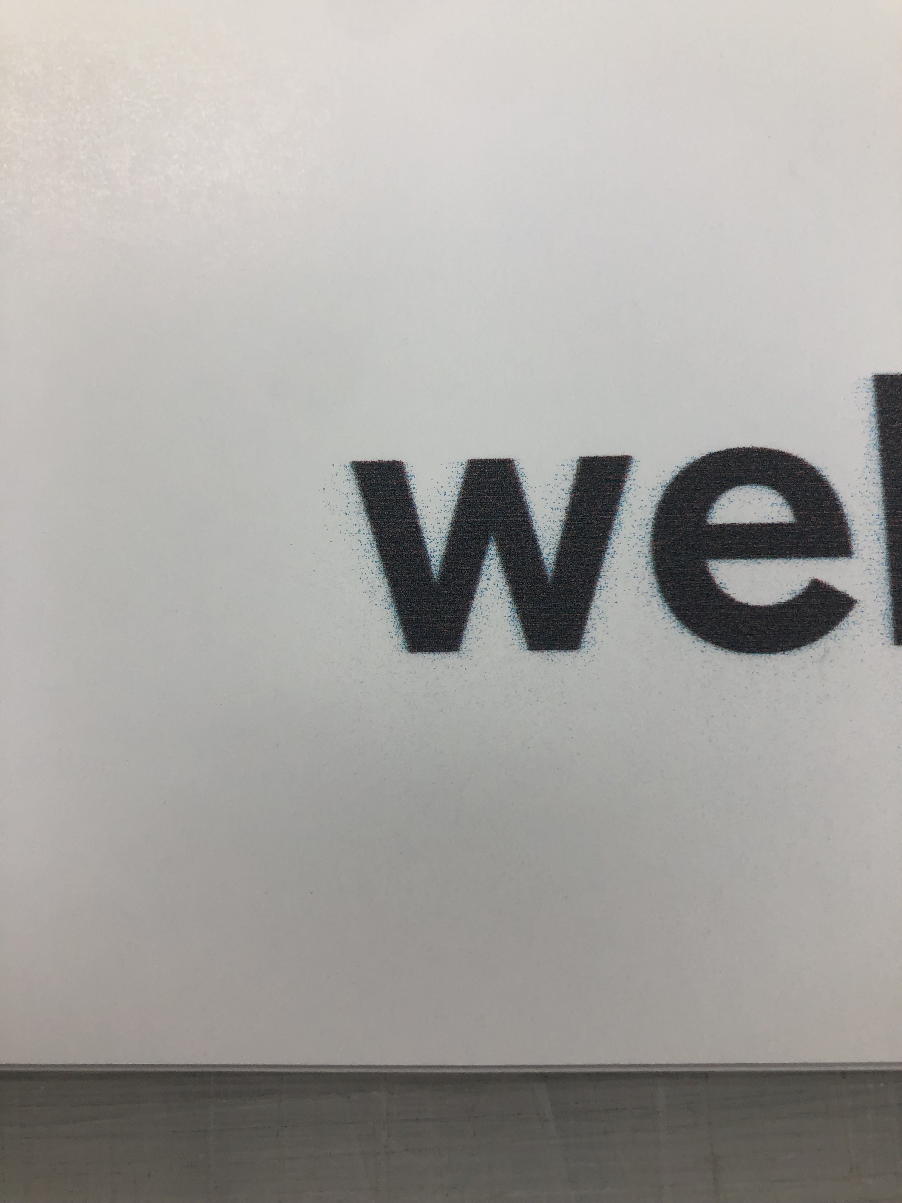

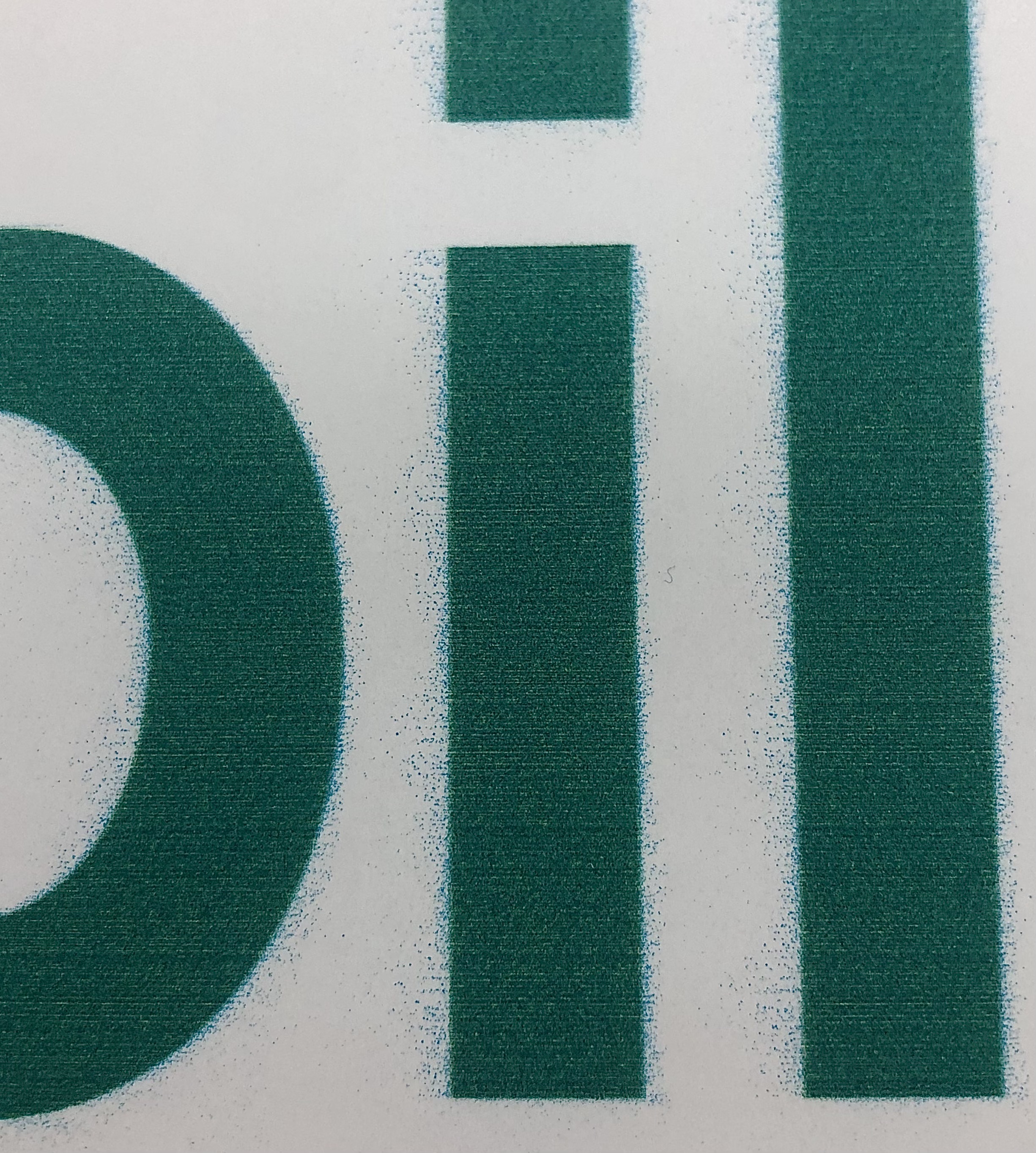

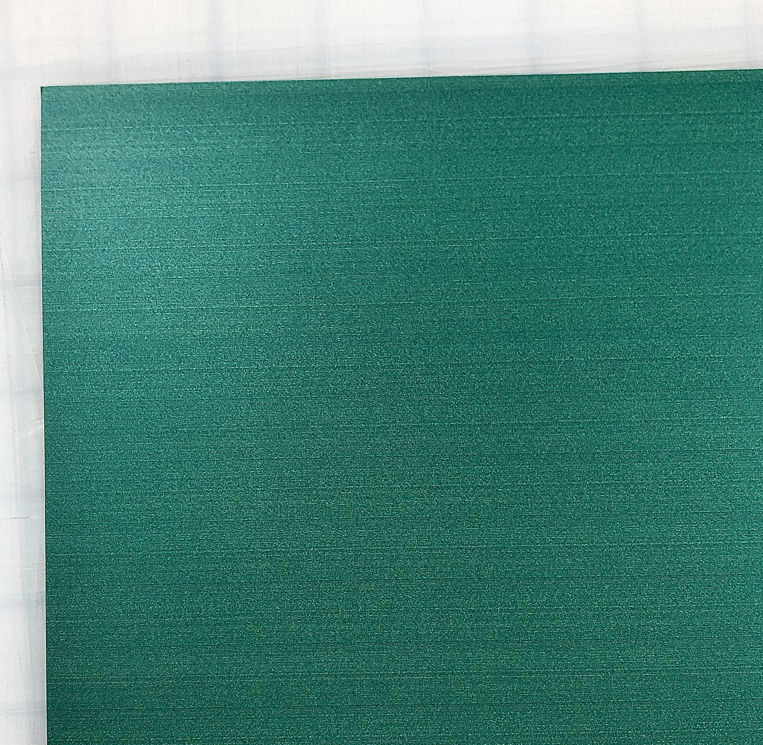

Our FB700 has a weird problem: Outdoor Signage Plus (600 x 300) has a cleaner print than Indoor Plus (600 x 600) ::see attached pics::
I did a manual BIDI registration and the LC heads are totally shot…it couldn’t print a line just a tiny swath of blur.
Turning on Fine Text helps a lot, but UniDirectional made it waaaaay worse. Anyway, the sharper/cleaner pics you see are OSP, and the ratty ones are ISP. Has anyone encountered this, where using higher resolution causes worse results?

That’s a lot of overspray. Let’s see a prime bar test print.
If it’s LC then you can run CMYK and that will solve the overspray if it’s coming from your bad LC head.
