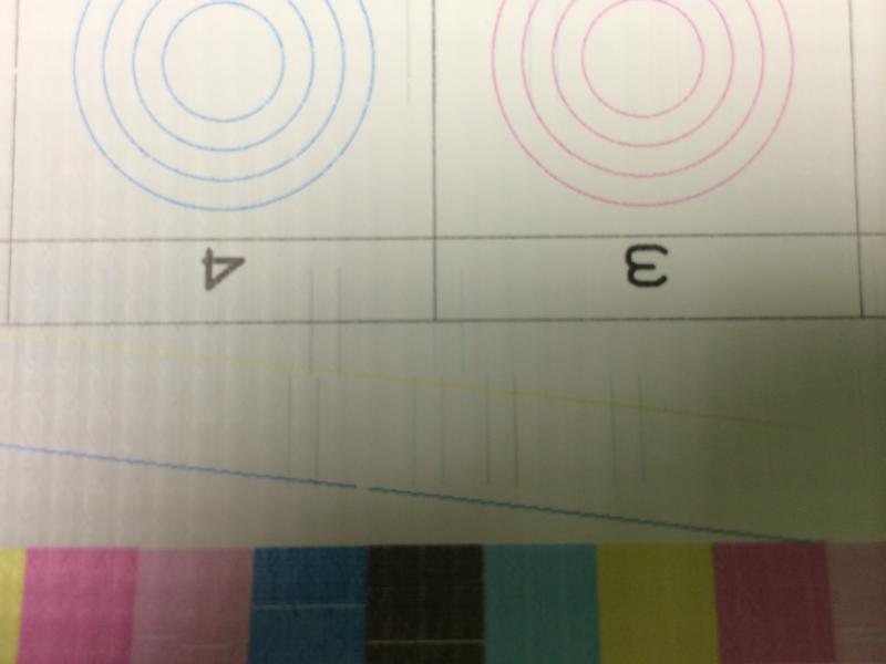

I have a 62 Mutoh Rockhopper/Falcon that has been giving me errant head firings. They show as vertical lines the width of the head in all colors from both heads. Sometimes there is 1 or 2 in a poster and sometimes there are hundreds. It occurs in both internal test prints as well as sent files.

I am including a pic of the problem and would like some advice on both the printing and board issue.

In my opinion. you are going down the wrong road in swapping out the motherboard.
I have seen this specific type of problem with Mutoh Falcon/ Rockhopper printers before (many years ago now) and I believe the issue is related to the linear encoder and/ or sensor. I have seen cases where the carriage rail was not well-lubricated and this caused vibrations that resulted in this type of artifact. I have seen cases where a dirty linear encoder itself, or a failing encoder sensor causes this.
I would first clean, and then potentially replace the linear encoder strip (T-rail), the encoder sensor (clean then replace if cleaning is not effective).

I see your wisdom and have cleaned both it and the encoder reader to no avail.
