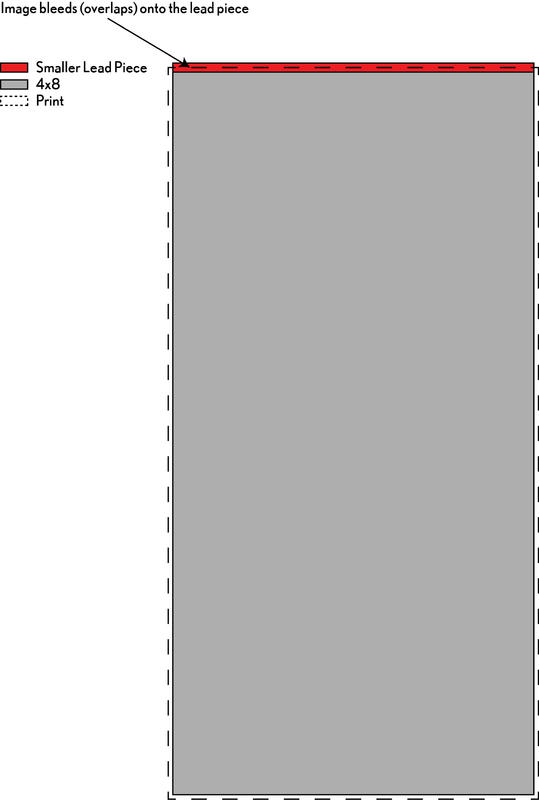

Pat, do you have a photo of this method, I read this twice and not getting this?
Andriy
Hi, had a minute so created this quick sketch.
I believe this is what Pat has described which is how we do it at our shop as well so I hope this helps! (It doesn't show the tape portion but I'm sure you will get it:smile:)
^Yup that's pretty much all there is to it!
Other than the tape holding the sled to the board, and the tape hinge holding the print to the sled, that's all it is.
It's pretty much fool proof once you get the hang of it.
edited to add because I'm a stickler for detail: I do like to make sure the sled is 6" - 8" long so you can get it into the first set of rollers before you flip the print over the laminator.
Pat, ok I get it now (almost) thanks to Andriy's sketch, and I assume that you tape the sled (6-8") and the substraight together on the bottom, but where do you put the TAPE HINGE?
Andriy, Thanks so much for making the sketch, as Confucius said "a picture is worth a 1000 words". Many times people are very familiar with a process (they see the images in their head) however when they use words to describe the process, flip this, turn that, put tape on the edge, etc, and if you have never done it, just reading the words can be a bit confusing.
