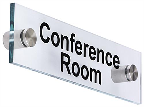

We have customer who redesigned office space with pretty much all glass walls, Old offices had acrylic standoff panels mounted next to entry doors for identification, Are there possibilities of mounting something to the glass walls? We don't do much in this area, and hope someone might help with some ideas,Any input would be appreciated,
thanks mark
The pic is similar to ones they had mounted previously,
