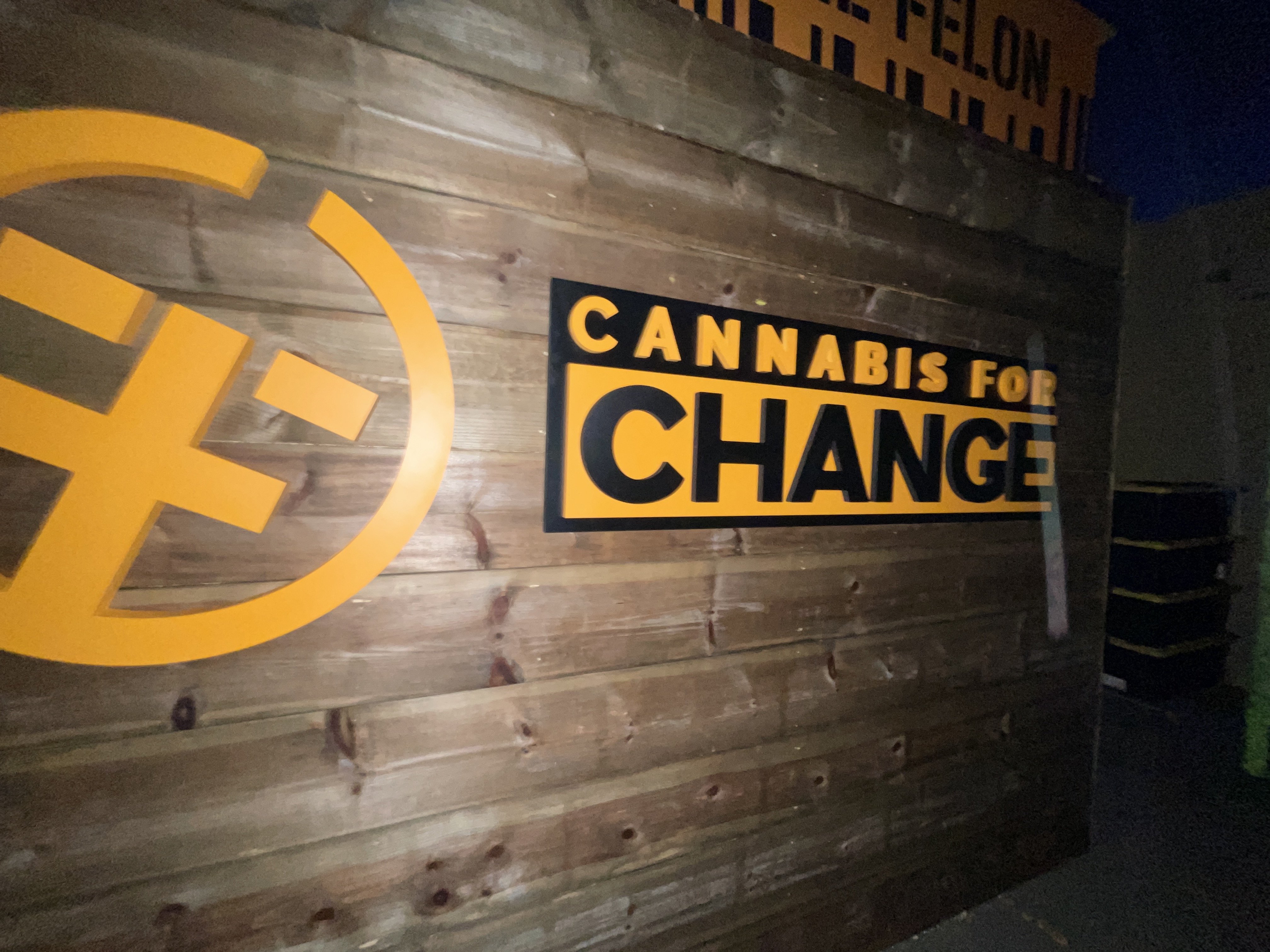

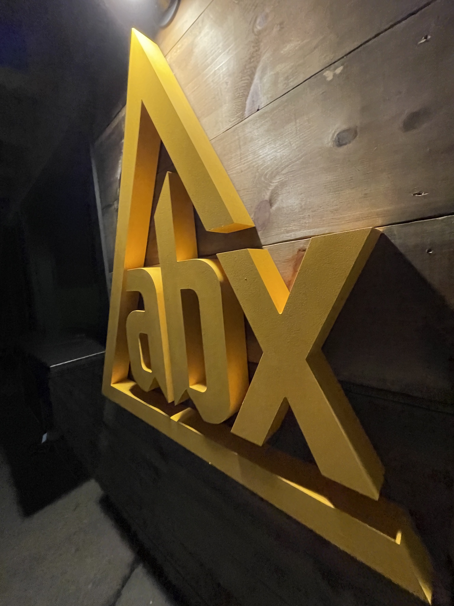

Thank you for the Suggestion on 1/4" studs. This is the final product.
This is 3 layers of 1" pvc glued/screwed together then prime/paint
