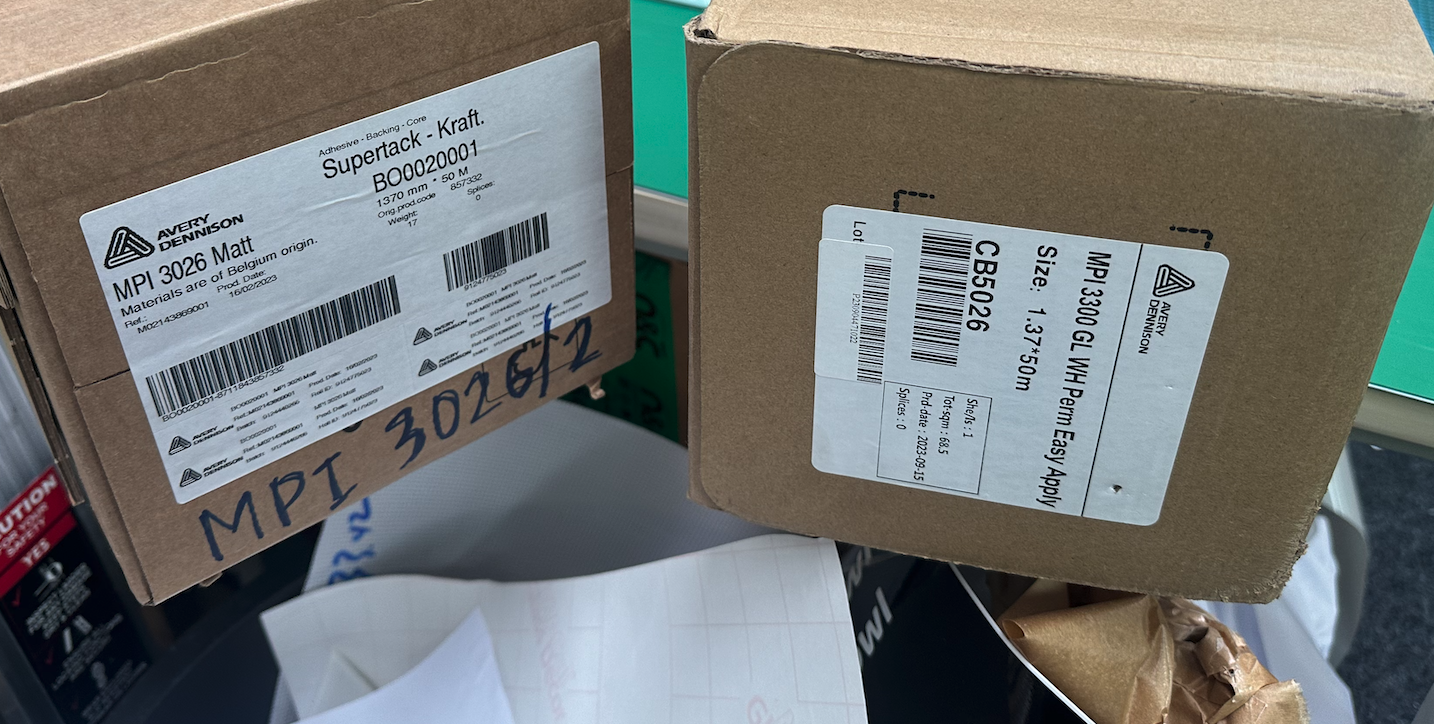

- What Kind of MPI3300, I know there are different factory ( Belgium, China or US) produce MPI3300, they might be quite different. (MPI2903/4 was from US and now from China, thery are totally different)
- We are in NZ and all the stocks come from China Factory they have 2-side PE Coated Liner.
- 2-side liner is very improtant for latex printer as thery are very high curing temp.
