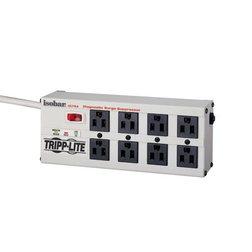

phototec
At Dell we used the Tripp Lite ISOBAR8ULTRA 8-Outlet ISOBAR Surge Protector, so I figured if it was good enough for Dell it would work for me to. It comes with 50,000 Ultimate Lifetime Insurance; lifetime product warranty.
Product Features
  • Ultimate protection with 3840-joule surge suppression rating
  • Exclusive isolated filter banks eliminate line noise interference
  • Indestructible all-metal case won?t crack, burn or melt
  • 8 surge-protected AC outlets, widely spaced to accommodate up to 4 transformers
  • $50,000 Ultimate Lifetime Insurance; lifetime product warranty
http://www.amazon.com/Tripp-Lite-ISOBAR8ULTRA-8-Outlet-Protector/dp/tech-data/B0000511U7
Custom_Grafx
Thanks for all the useful info.
I currently have a Belkin surge protector unit. Better safe than sorry for sure.
