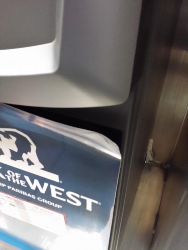

Anyone using MSI ProMag? I have been having more problems with Magnum Magnetics and looking to make a switch.
Thanks for any feedback.
Christian @ 2CT Media
Magnum owns MSI, supposedly its even the same product now. We have been using ProMag for awhile and switched back to Magnum SignMag, the ProMag was curling in on itself. Magnum says we have to use a cast vinyl, we've never had the issue with SignMag and still haven't so we went back and pay the same price for both.
Magnum is saying we must use cast? Why would you want to put cast on a material that is only going to last a few years anyway?
We haven't had any issues yet with Magnum (that we know of), but we don't do a whole lot of magnets either.
Yes when we placed a claim with magnum on 2.5 rolls of ProMag, Their response after receiving the bad mag was we used 3M IJ35c and its calendared we must switch to using a cast material since the calendared is shrinking stronger then the magnetic pull.
I told them we never had this issue with SignMag and they said its the same product in a new box. We immediately paid out of pocket to replace all the bad magnets with SignMag and it hasn't curled since and that was months ago.
