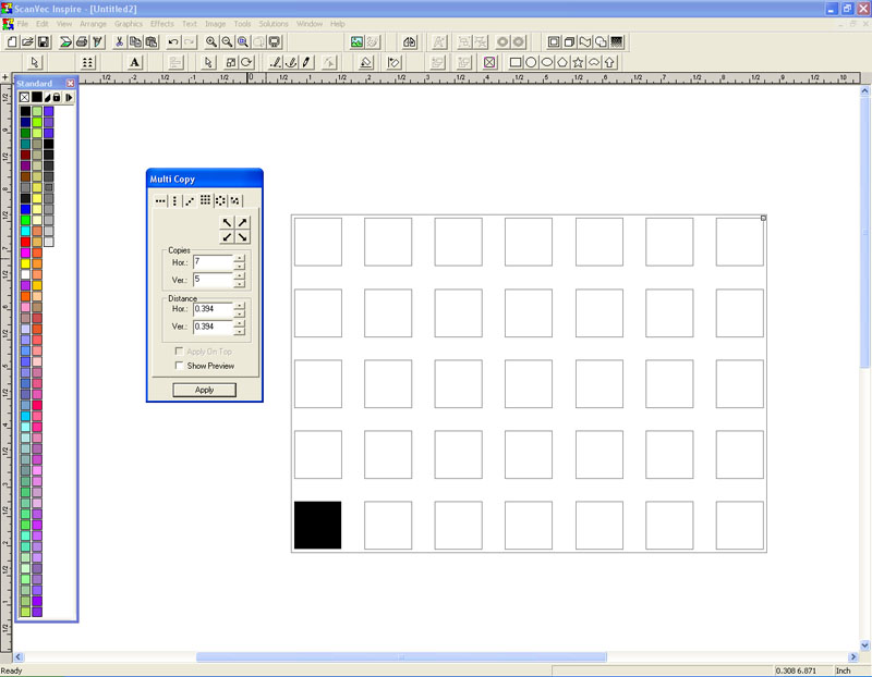

My beloved old ScanVec Inspire 1.6 has the ability to do multi copies (vertically, horizontally, both, diagonally, and circular); is this possible in CorelDraw X5?

Thanks. Tried it. Utter crap compared to Inspire. You can't seem to do a multi duplicate vert & horiz at the same time. I tried a horizontal multi copy, and that worked, but then I selected that group and tried a vertical duplication, it insisted on going diagonally only. Grrrr

Ok, got that to work. Cannot the vert & horiz duplication be done at the same time (as shown in my JPG in the O/P)?
