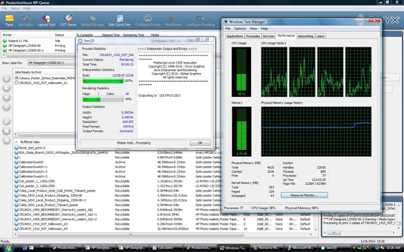

Bly
Vista 64 bit Business version, ProductionHouse 10.
Ours seems to use all 4 cores.
3 hours to rip one car?
Something sounds seriously wrong unless it's massively complex vector art.
