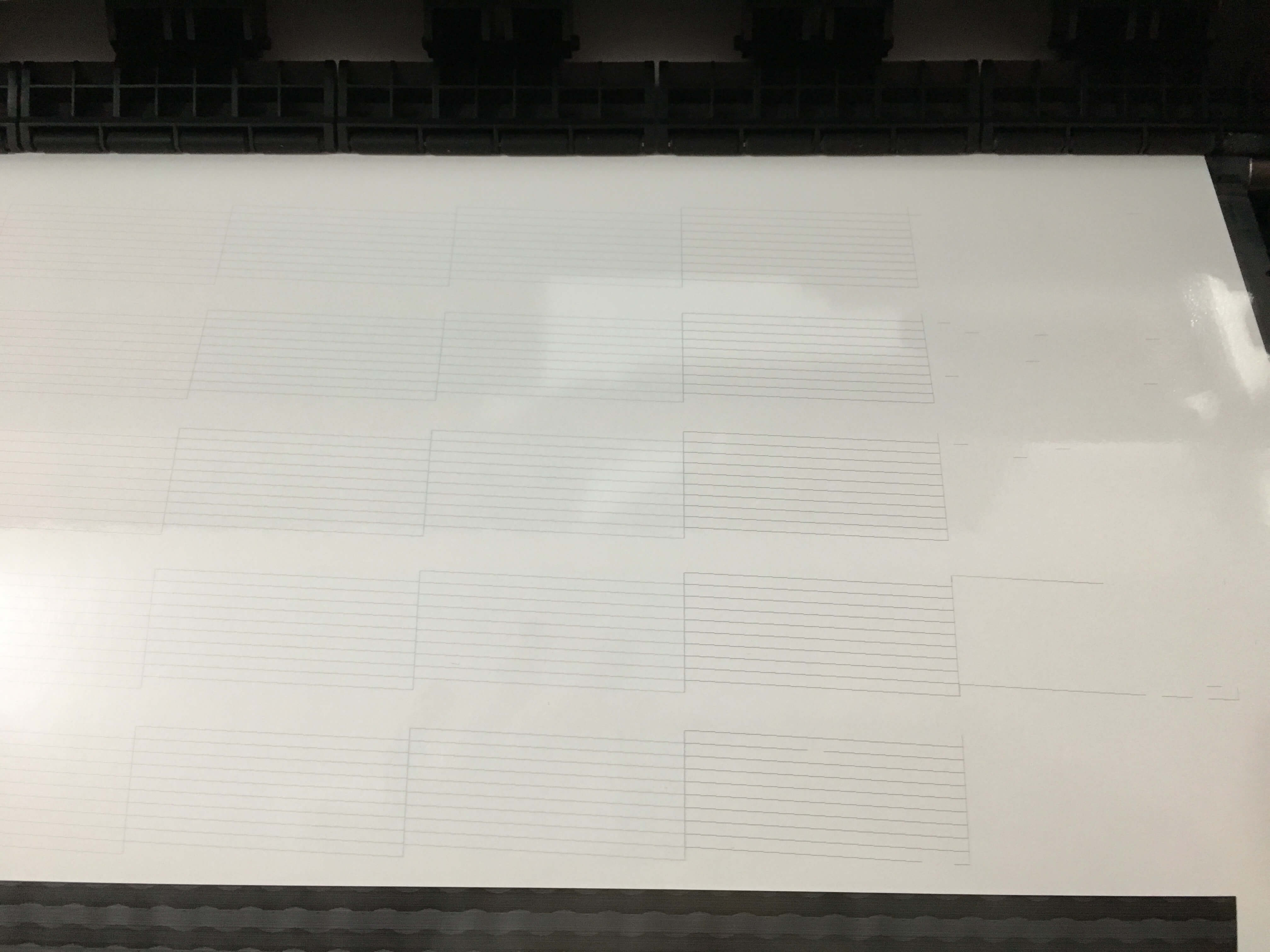

Purchased a new head for my mutoh 1204, installed last night everything prints well but one black. I have replaced the dampers they came new with the head, I have pulled ink through with a syringe several times still one of my black nozzles are missing. Any ideas, thanks
purchased the new head from solventinkjet.com
Solventinkjet
DIY Printer Fixing Guide
Are you seeing any air in the ink lines on the black channel? It could be a few things. Feel free to give us a call!
Ppcwilly
Thanks Craig from solventinkjet, my cap top was not seating quite right. It is printing right now.

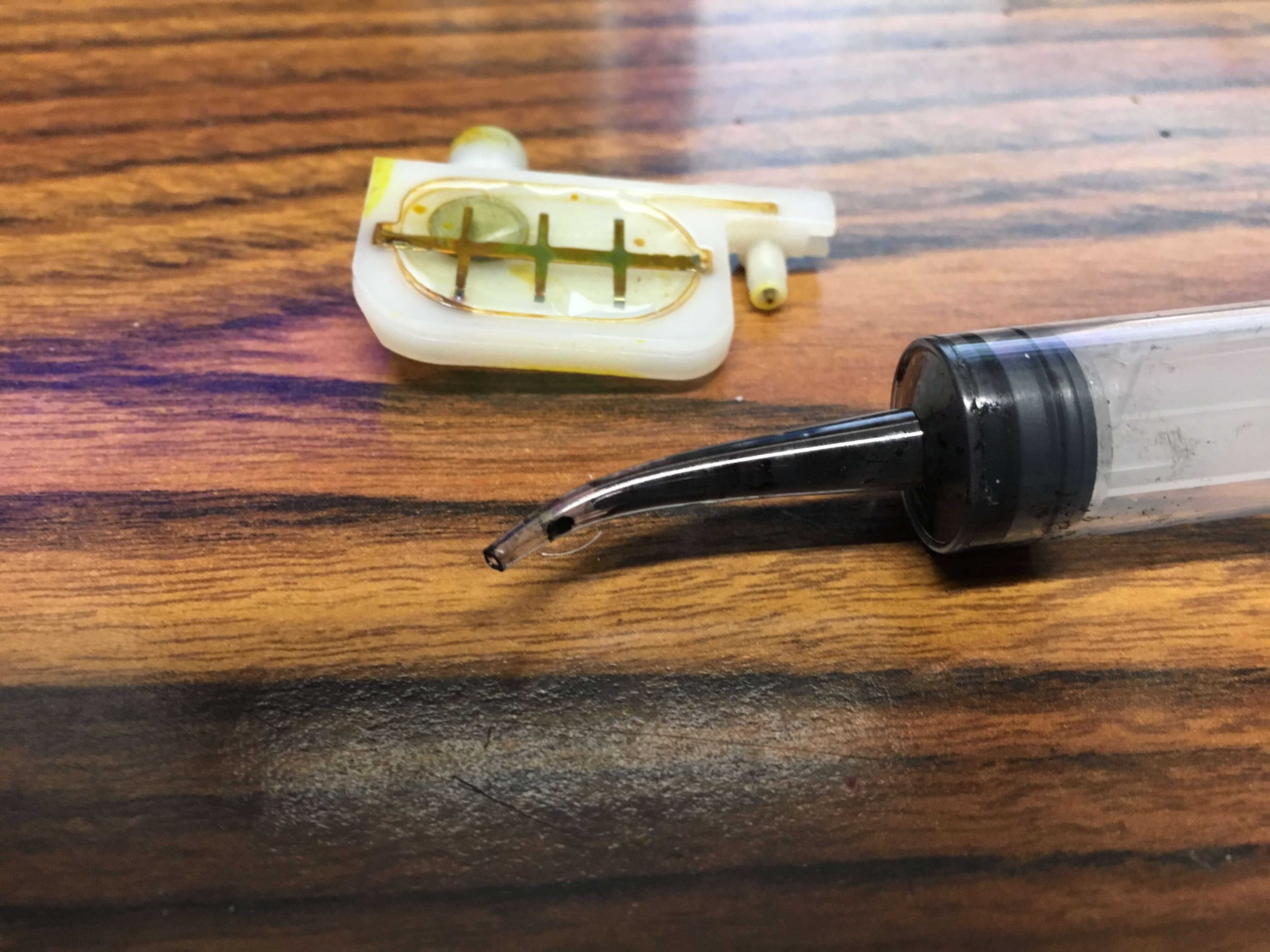

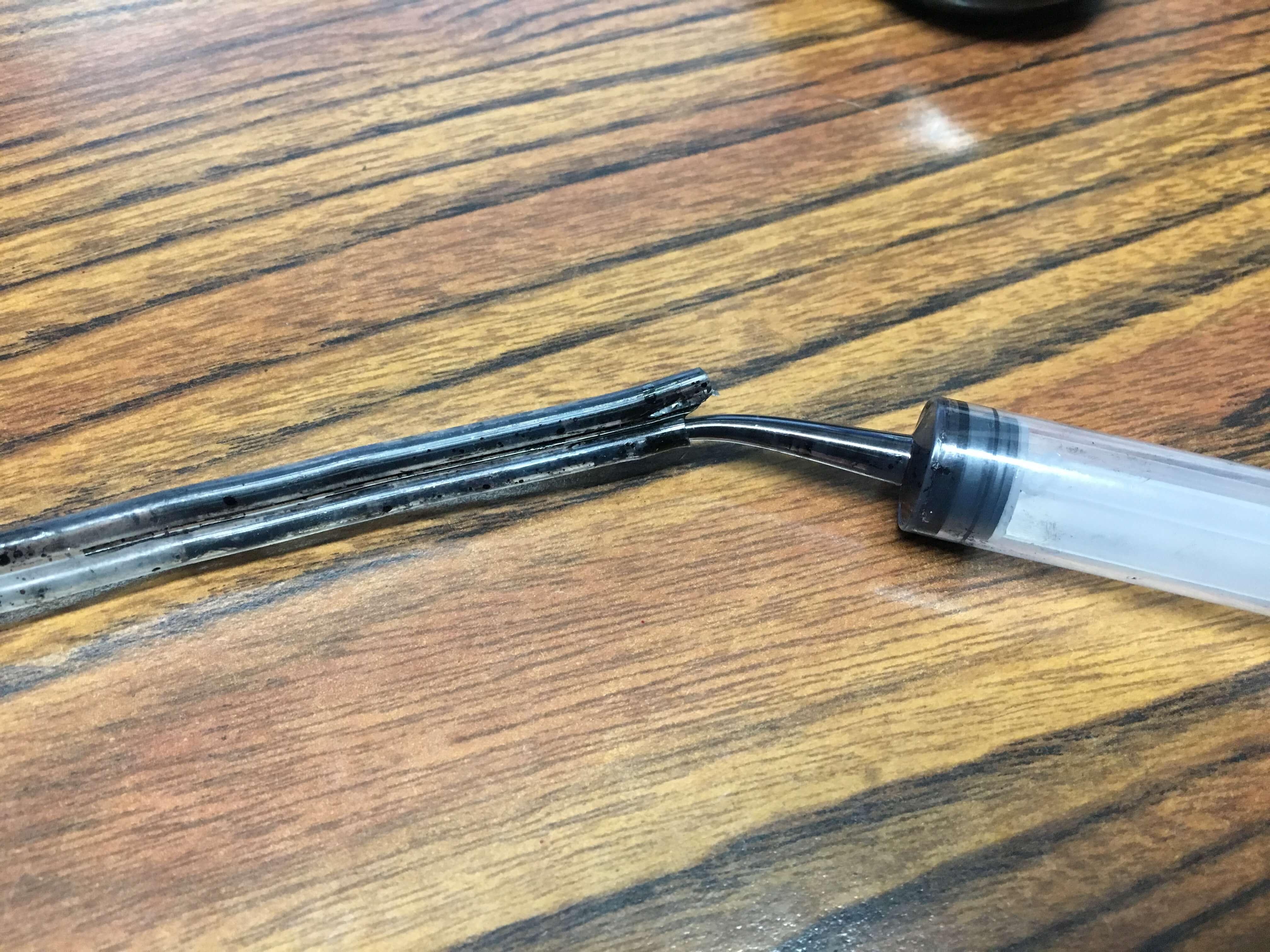

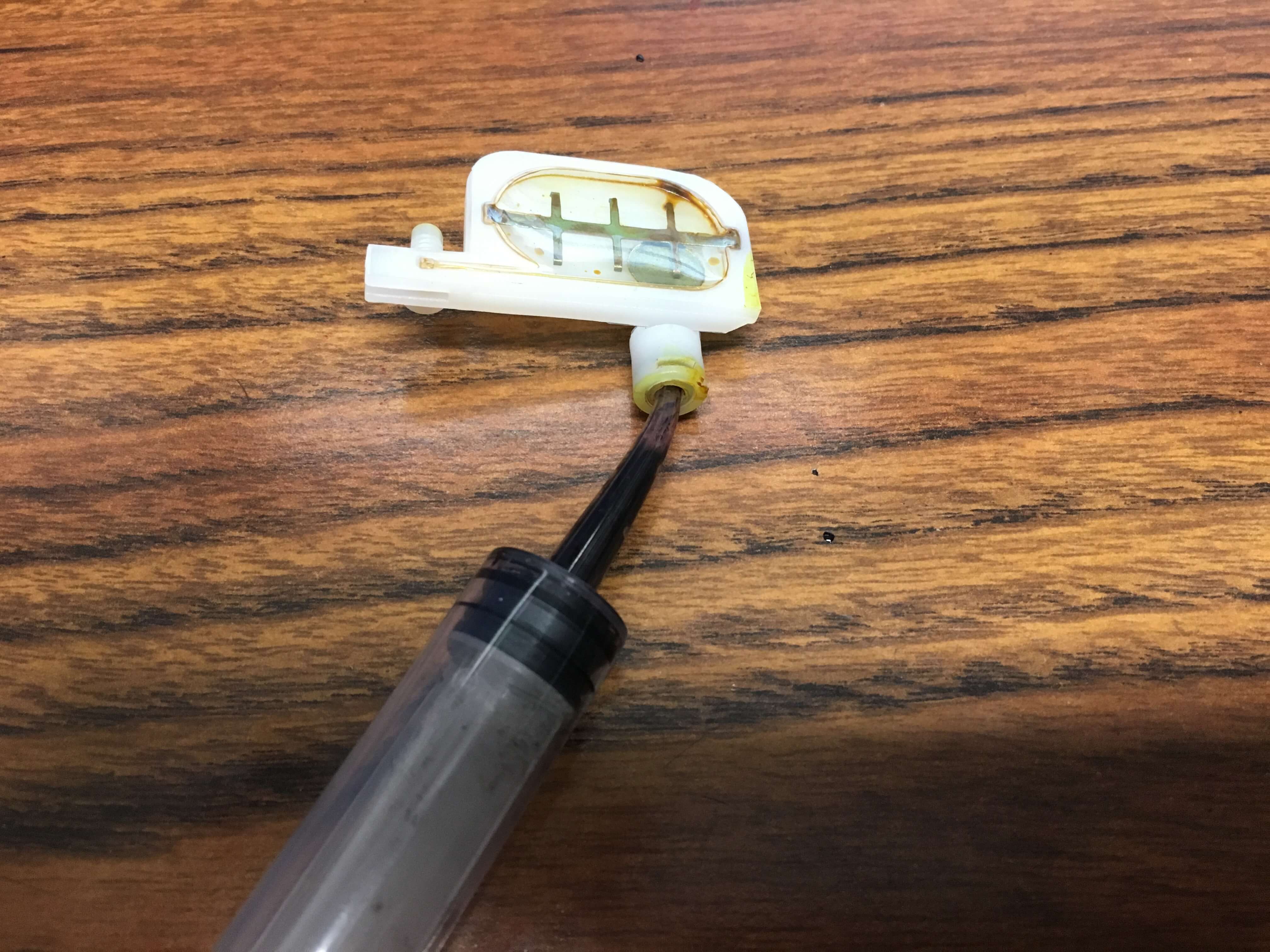

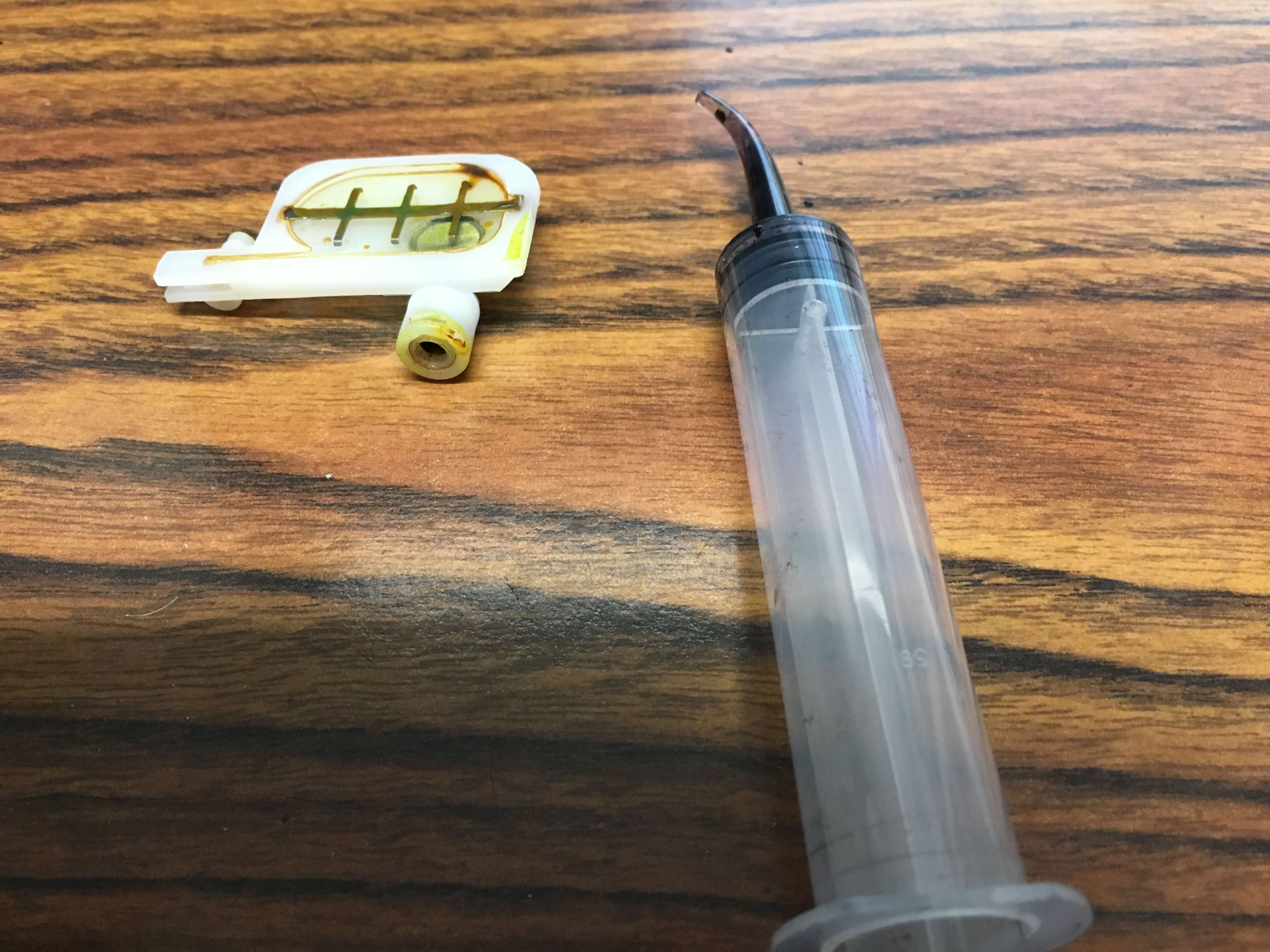

I have a new head on hand and need to do the replacement, which I have never done. You say you pulled ink into the damper with a syringe, call you explain that procedure for as I don't know what that is? Thanks a bunch!
Ppcwilly
Do these photos help?
Ppcwilly
added photo, pulling ink through the maintenance station ink drain lines.
