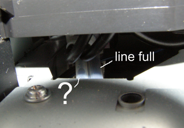

Mutoh 1204 Maintenance Station replacement, something I can do?
Not getting much ink though the lines, one line I can see only drops.
cyan 2 nozzels not firing, I was told it may not have the suction to clean
itself properly
Would Mutoh be help on such things?
dclet
Would replacing just the capping station work also?
replacing the compete ms seems a bit odd? $495 compared to $75.00
Stealth Ryder
It's not hard to replace, just time consuming. Kinda like putting a puzzle together. Just pull the right end cap off and go for it, 30 minutes later you will be finished...
