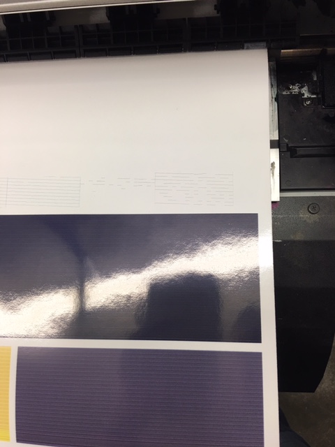

early nozzle checks picture is how we started, ignore the ink splatters, it's a crap storm over here today

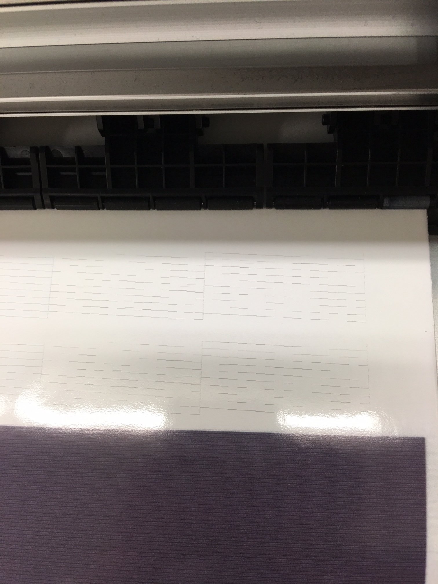

last nozzle check picture is what we ran before calling craig to see if we needed to keep doing cleanings or were wasting our time

I think Craig is correct, it looks like your black channel is toast.
I have a 8-9 year old 1304 and the black channel is the only one that clogged bad enough to require a head replacement.
I've done the soak on top of the maintenance station with a folded cloth - the remove head and soak on the bench, the swap the black chip onto a cleaning cart and print cleaning solution through the head - none recovered enough nozzles to justify the time wasted.
On the bright side you do get to know a good deal about your equipment. Gave me enough confidence to buy a new 1624 with the only tech support being me (and this list).
Good luck with your repair. Head change is not too hard - lots of help online. Most important note is to make sure the machine is unplugged - discharged and the person working on it takes precautions with static.

I received it! Thank you very much! I know it will definitely help us. Now tonight's question...husband flushed printhead and we felt there was improvement. I'm attaching a picture of our last nozzle check from a few moments ago. It's definitely better than last night, but am I getting false hope?
Has anyone ever recovered from a clogged printhead? or are we just wasting time and cleaning solution?

Still looks pretty bad but is getting better. Maybe give it a few more tries before ordering that new head.

We were able to recover a print head on a 1204 as bad as what you posted. Perform factory function: head wash might will help a lot. Have you done so? You would need a lot of cleaning solution.
JasonMeisnerSTS
I would push flushing fluid through the head on each channel 3-5 times; If your nozzles don't come back to an acceptable level, time to change the printhead unfortunately but I have seen heads come back that are this bad or sores if done properly
