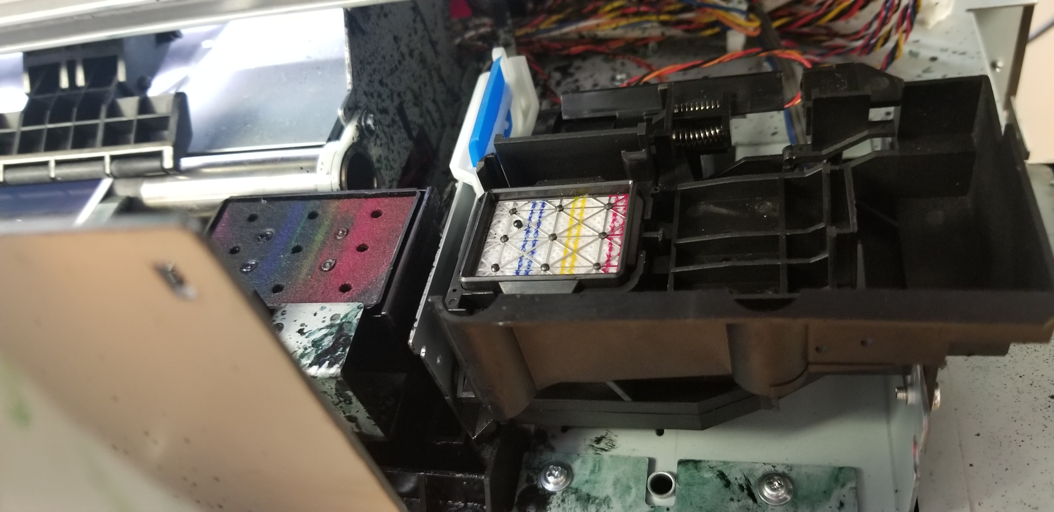

Here's a pic of the new maintenance station installed as I'm printing. It looks like the cap is only showing CYM, No Black is present on the cap?
You shouldn't be able to see any white in the cap top if the station is working properly. The lines you see are from the head firing into the cap which means those nozzles are firing but the station isn't pulling the ink through like it should which would make sense why the black isn't firing because the station isn't pulling any ink down. I have seen that type of wiper before, which isn't OEM, and it came with a batch of bad maintenance stations we had to send back to the manufacturer. I'm guessing that is the case here or something else is out of wack.
