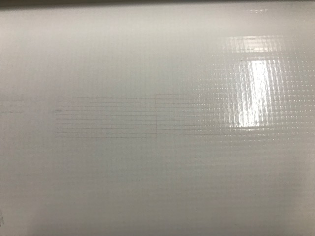

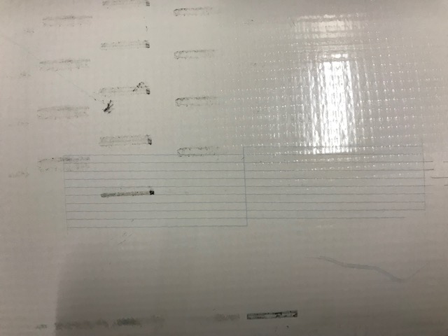

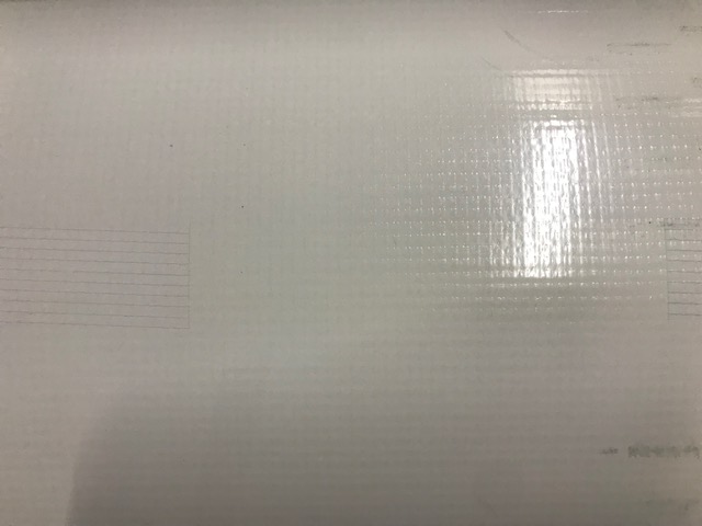

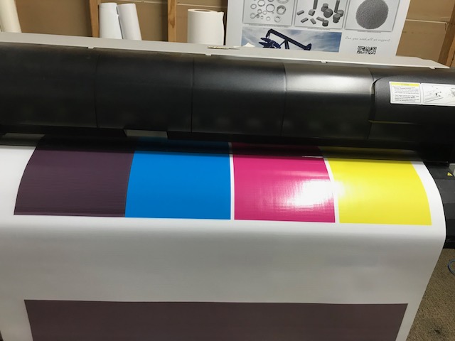

I replaced the old one. It works but I still get the black line clogged nozzle test. Other colors are perfect. See the picture attached. Please advise,
Thanks,
