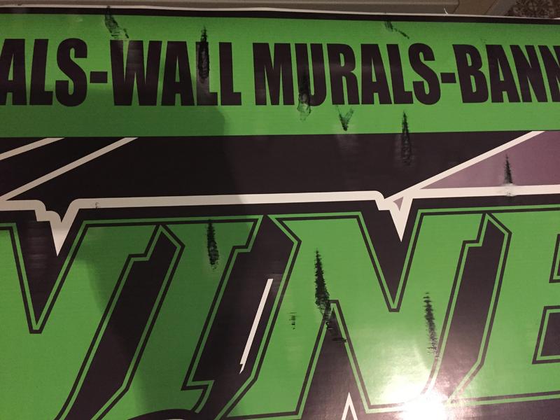

So I started my printer up today to print a couple of signs and in the same are on 2 prints I have got this black streak issue. Can anyone tell me what is going wrong here? Thank you in advance
CS-SignSupply
Head strikes from media raising up off the platen. Wrong heater settings, humidity, bad media.
Resolve or risk damage to printheads.
sixninedesigns
Fixed!!
Thanks everyone!! Somehow my heat settings were all at 50 so i lowered them down to specs and it seems to have fixed the issue. Guess i was just over thinking everything and missed the small stuff.
