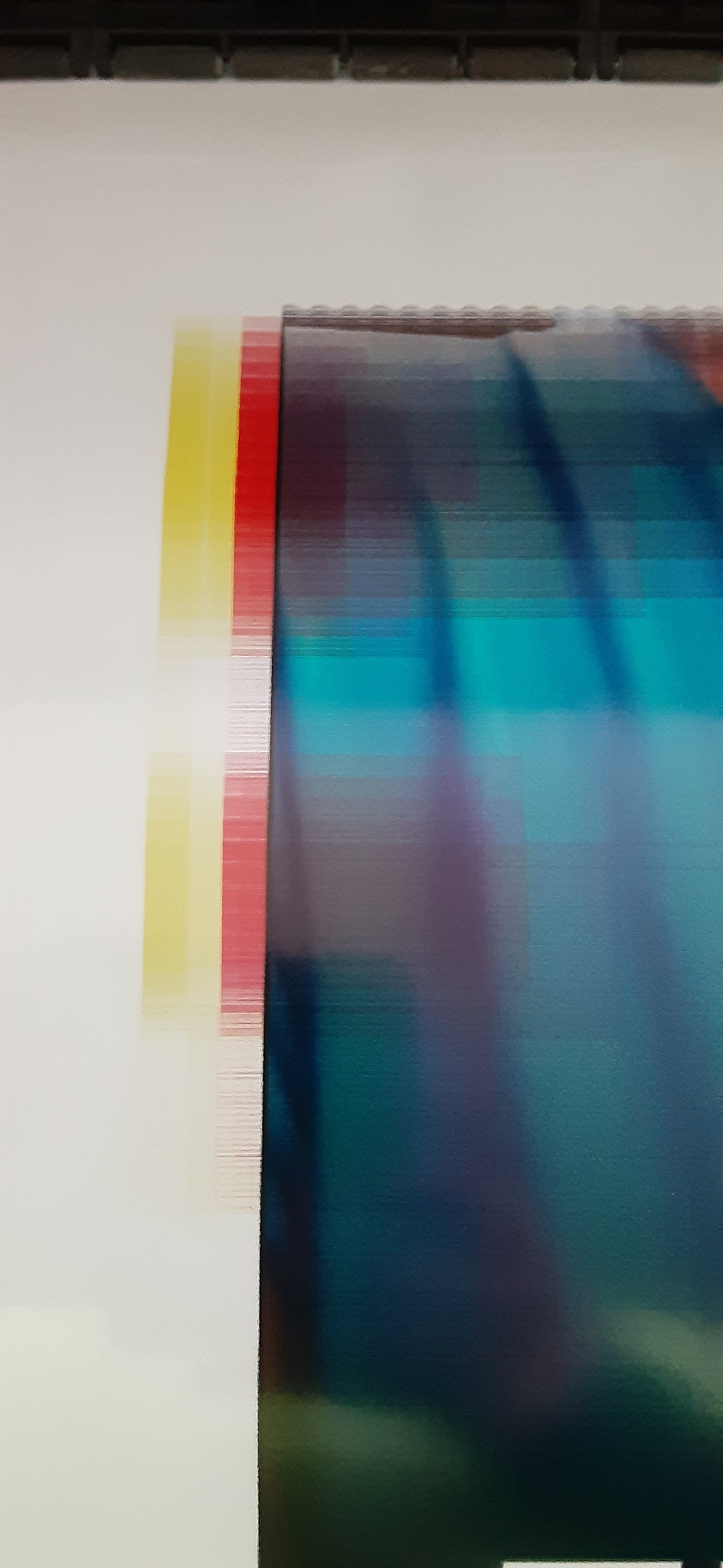

I have a mutoh 1204vj how do i fix this help

Check your cable connections for partially plugged in cables, damaged leads, corroded or dirty leads, anything that would cause a short int he head circuit. Basically the head signal is getting messed up due to a bad cable or even possible damage to the head or one of the boards.
