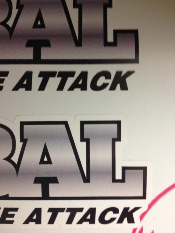

Attached a picture. Top is what I'm getting and the bottom is what it should look like.

The photo is not very clear but it looks like overspray to me, what is the printing direction of that sample?

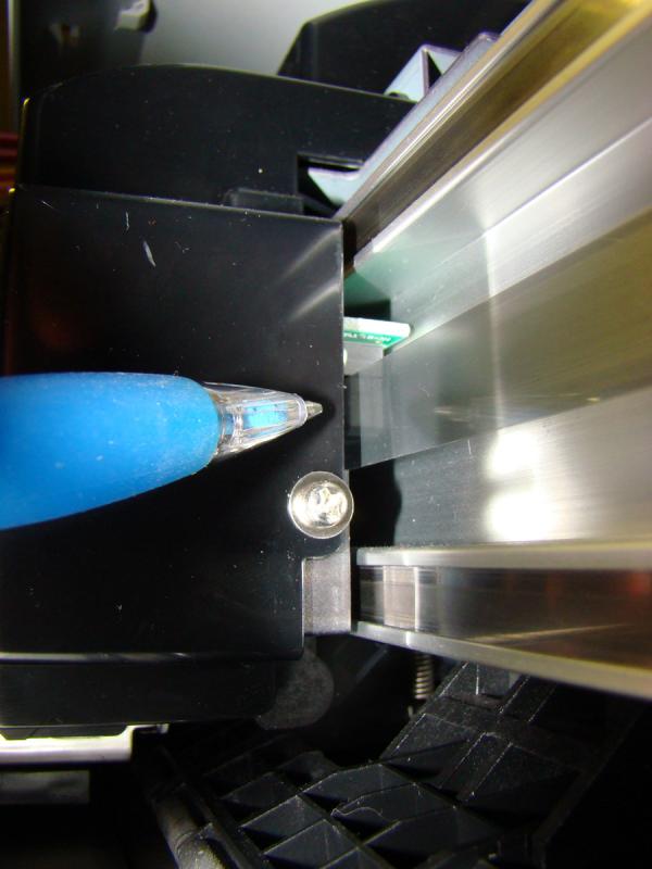

Is the Head level? Release the head from the Home positiom and compare the bottom of he Head to the Platen... I have seen this as well... If the Head is higher on one side or the other (Left or Right) this could be an issue... If so, it will need to be re-installed so that it is level...
GmanDesign
I took the pictures facing the printer do what you see is how is came out of the machine. The one that is clear is one from the customer last order i just stuck on to compare.
I'm on a concrete floor.
Head is level cause that was what I checked first.
