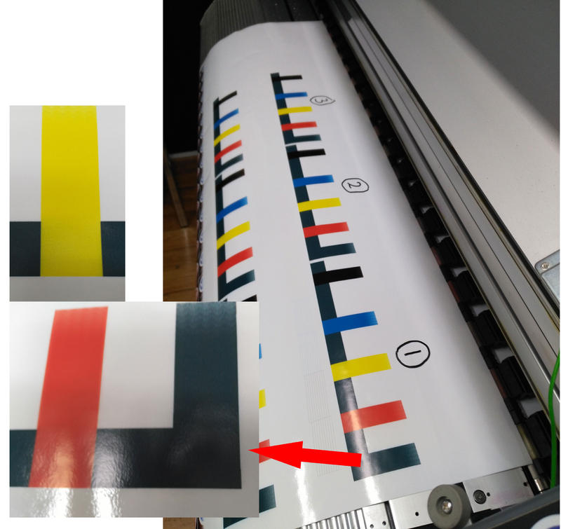

I recently change a new printhead and being getting hairline printout on the edge . I using the media profile that matches the gloss vinyl . In each case it seems to be worse on the side nearest to the head docking station and end ( NO 1 and 3 ) And seem better at the center ( NO 2 )
I’ve attached some pics below for reference
I’m very new to digital printing and I hope that someone here can help.

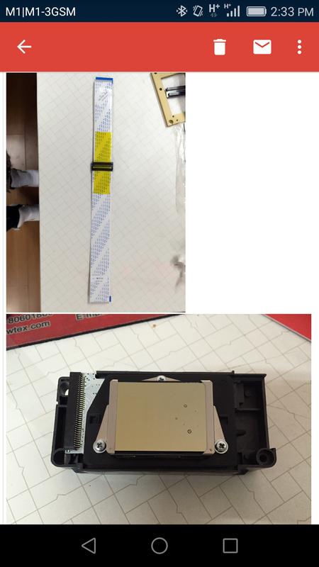

The previous 2pcs DX5 china head need to go through a decoder. It's works fine. It's just that the epson stop production. This 3rd head no need decoder, but need to convert the 35p to 31p cable.
Was figuring out is it the head problem or other problem that cause this.
