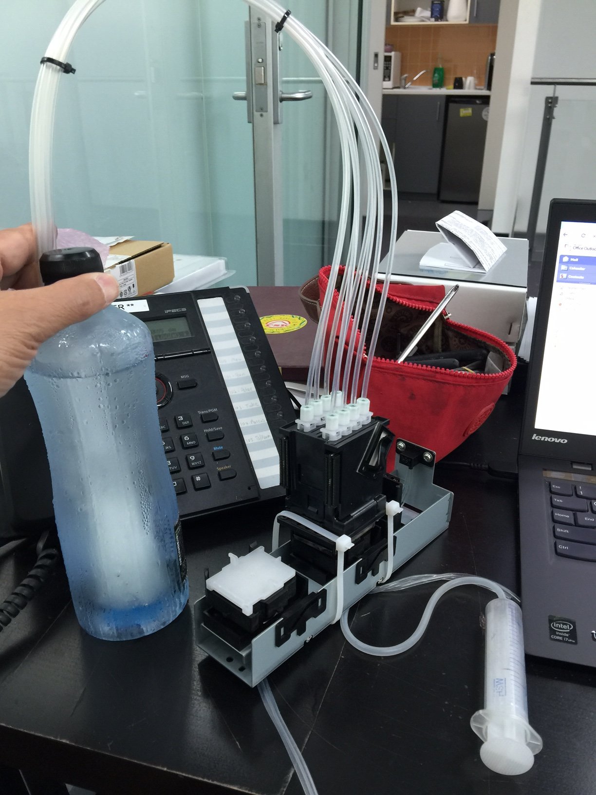

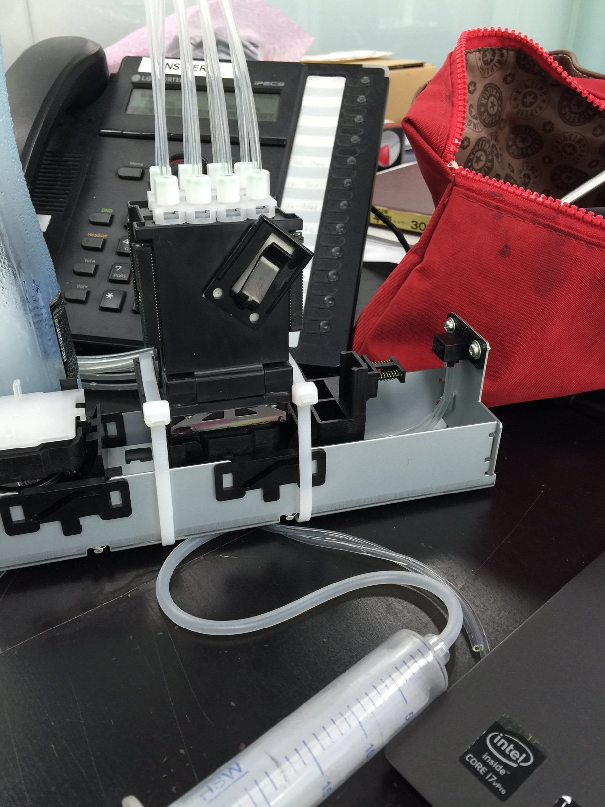

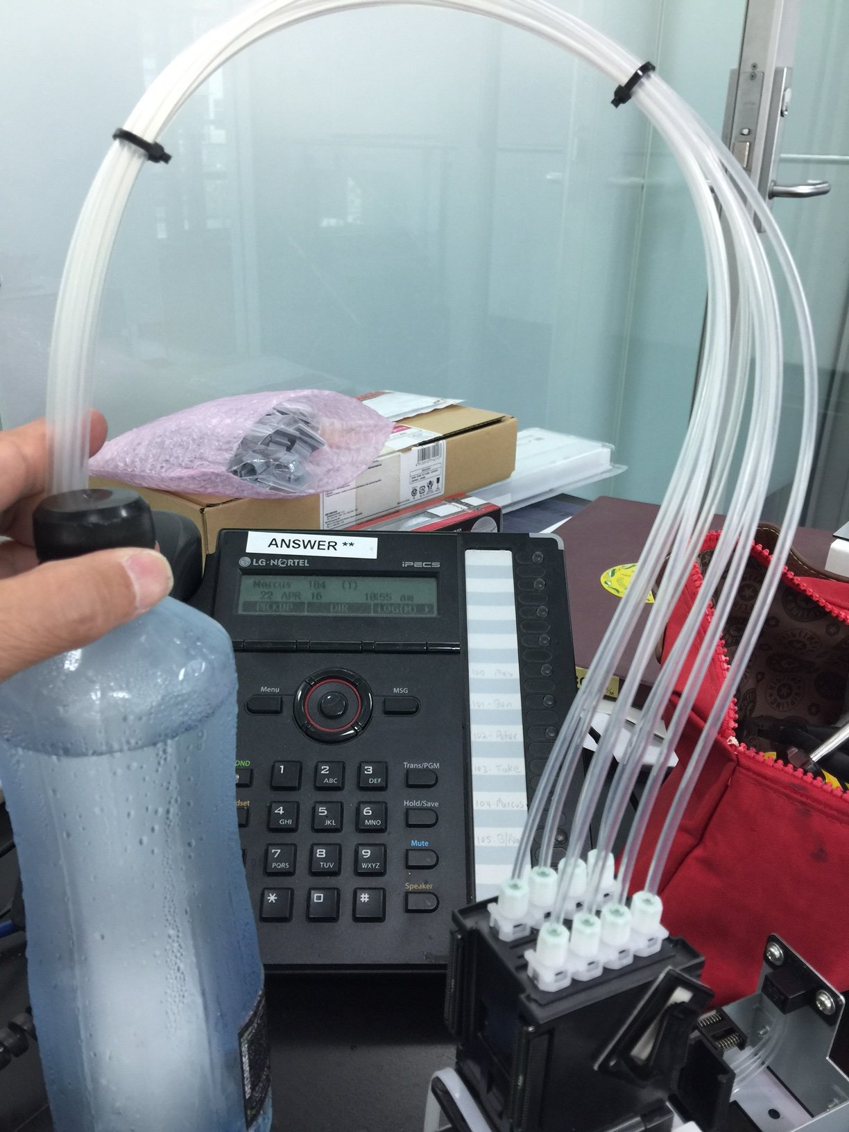

I would push cleaning solution through the head using a syringe as a last resort, just be careful that you do not exert too much pressure or you can cause more damage the head. I have made my own improvised cleaning jig, a bit crude but effective.
