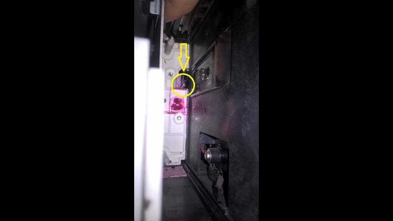

hie guys i attempted to do a longstore on my mutoh 1624 and it asked me to remove cartridges, i then removed them and it kept asking me to remove them.. i switched it off and switched it on now and it seems i have to complete the process of which the machine cant detect cartridge removal, is there a way of aborting the longstore process, HELP GUYS.

I think your problem is ink filled switch inside cartridge holder like on picture.
First of all you have to check and clean switches.
Procedure can be aborted in diagnostic mode.
