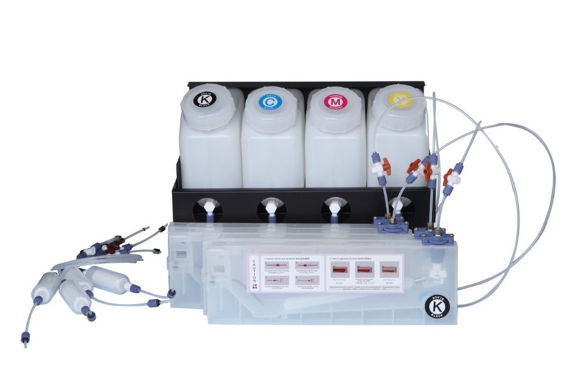

inkmed
the latest CISS include floats in cartridges and filters between tube.
This can ensure the printer heads avoid clog.
Attachment is picture of the full CISS.
Adam Yang from Inkmed
