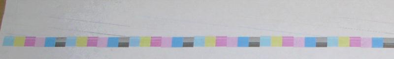

redmondcopy
Well here's where I'm at after doing the sonic clean 4 times and doing a couple cleanings in the printer. Any ideas or am I needing to by new print heads?
Thanks,
Grant
midnightmadman
The heads are WAY out of alignment, but the nozzles look like there getting clean.... keep going.
But once they are all running its alignment time!
