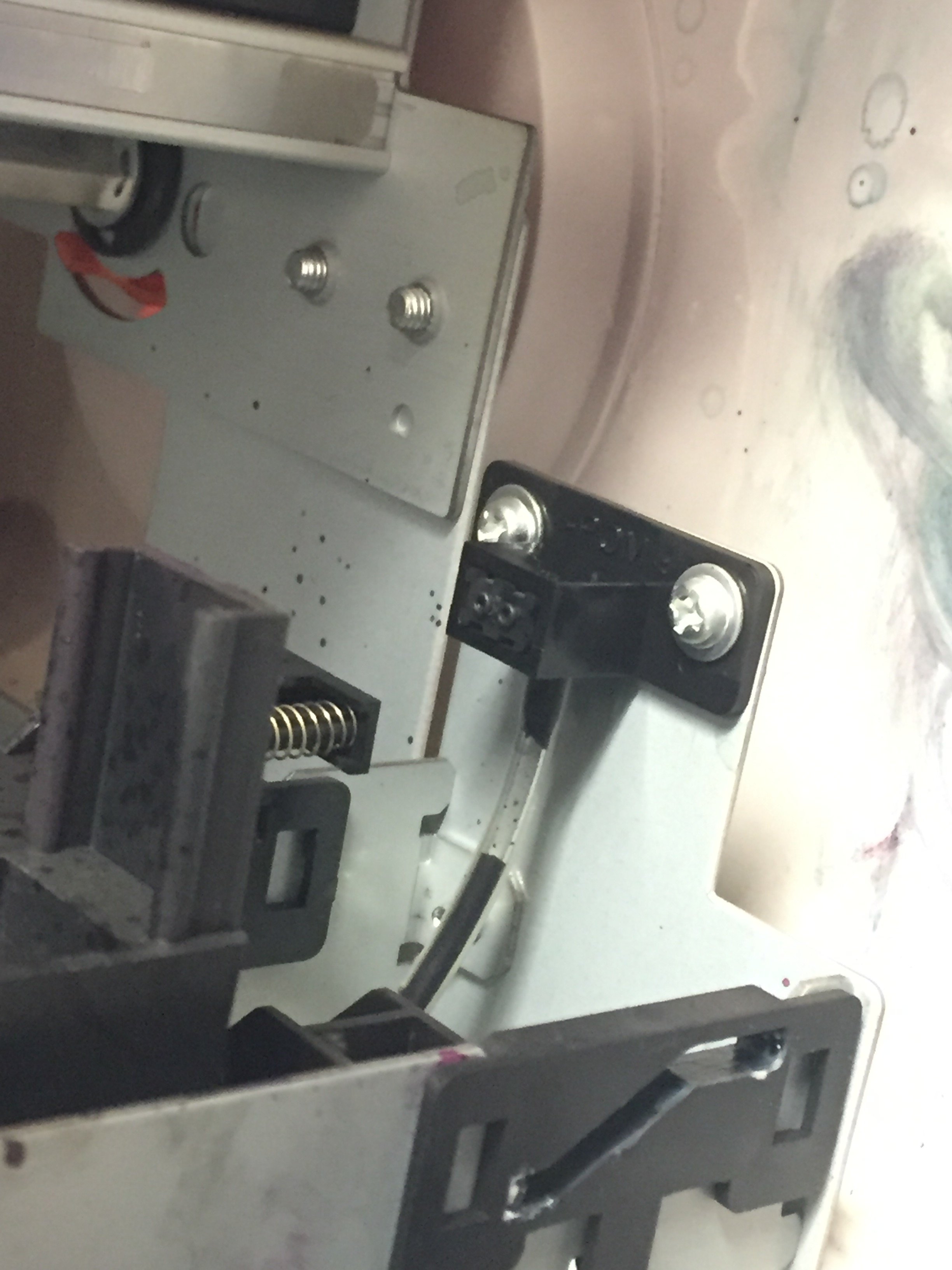

I closely inspected what happens inside when the printer powers itself off:
What’s happening is that the head will come to it’s capping station to do a clean, then the print head then surges twice all the way against it’s stop, the rubber wiper comes up instantly creating the clicking noise, and then instantly after that the printer powers itself off.
I noticed what looks like a hydraulically actuated sensor with air in the line (pictured - this is on the right-hand side of the Mutoh VJ628).
Could there be any chance that this could be causing the issue?

I have a photo of the capping station (and a video of the shut down) if anyone had any idea as to what's going wrong :(

That picture is of the air release valve and it shouldn't have any fluid in it. That being said, it is not the best design and it almost always gets ink in it after a while. I don't think that is causing your issue.
I am willing to bet it's one of two things. Either the head lock mechanism is failing and the head is not being locked/unlocked properly which causes motor errors or the maintenance station is failing and the wiper is not moving as expected. Do you get any errors in your software when the machine turns off?
I'm wondering if the wiper is coming up too far and the sensor is not detecting the head moving over and therefore not slowing it down, striking the wiper and tripping the power switch from an overload.
