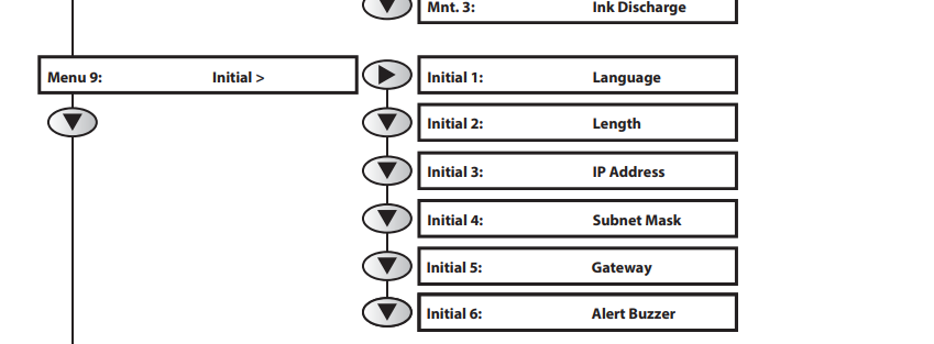

still having issues with the IP Settings not showing up in the menu as well (checked the menu options).

my menu options only goes up to 21 and none of them have the IP menus

i notice on some of the research ive done, the IP options are around 24-25

Yep tried that aswell,
Still wont show up, im not sure if i need to get through all the set up first before this shows up,

Figured out the IP Menu, This printer has it on a different sub menu, its in Menu 9 Initial, instead of Menu 3 Setup like other Valuejets. Just trying to get a ping now from the network.
