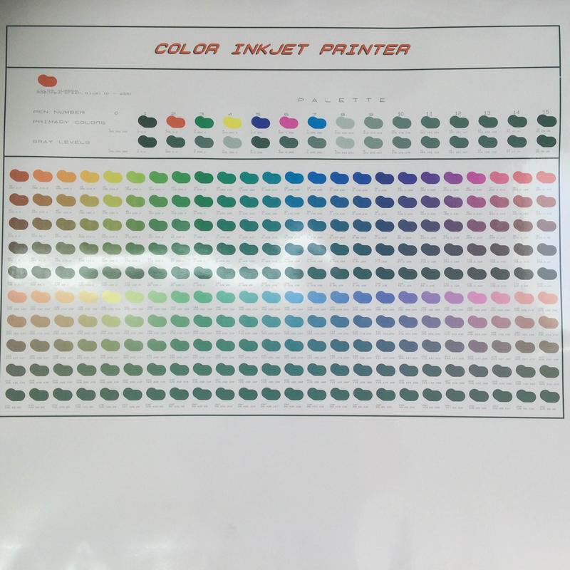

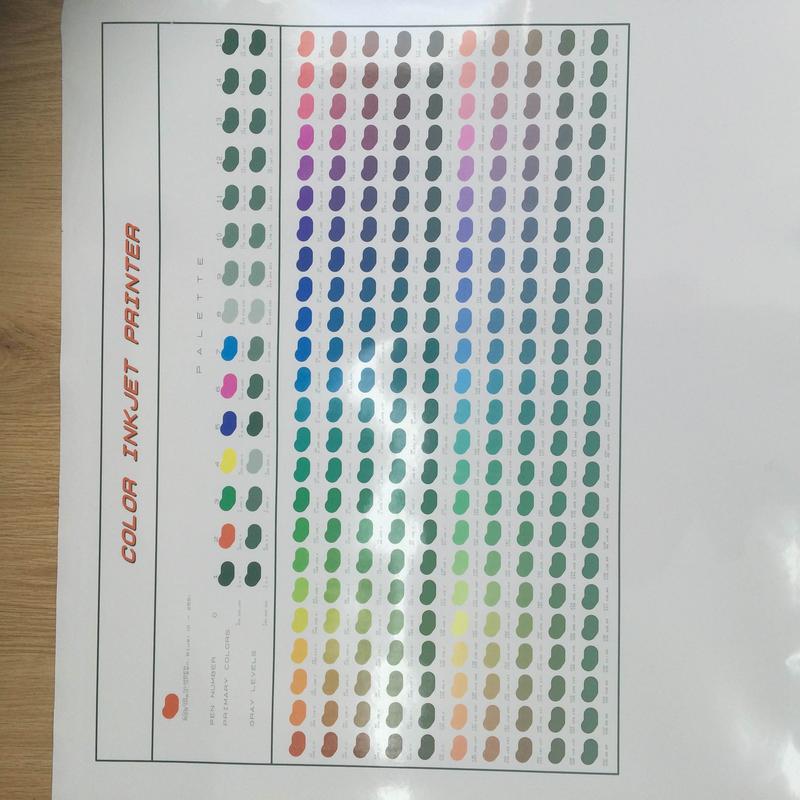

Very detail description. Please post a few photos on the pallet print and regular prints so it'd give us better sense of what to advise next.
Francis
Steve Brown
Pallet Test Images - Green Tint to Black
Thanks and please see attached Palette Test Images.
GAC05
Quit buggin' me
Your test prints look the same as mine from both Mutohs.
I don't think this test shows any issues with your K channel.
Have you tried to print some black with known values through your RIP after you changed out all the parts?
If your nozzle test is good and you get good blacks for regular prints I'd not worry about this test.
