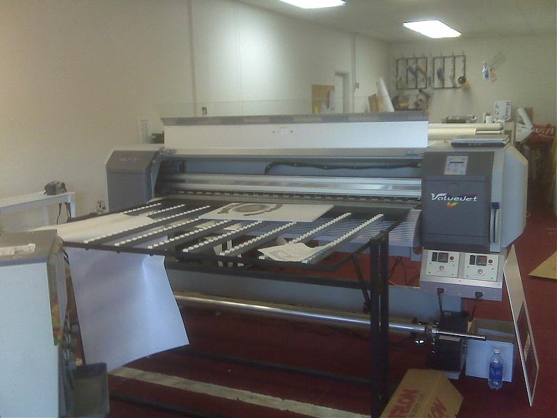

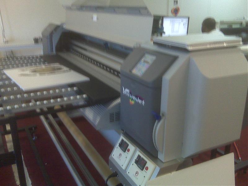

Well, we just finished day 1 of our very first install of the new Mutoh VJ-1608 hybrid printer. As you know, there's been a lot of buzz on this printer in the recent months and all I can say is WOW! This is going to be a hot little item for those looking to break into the flatbed market without spending a whole lot of cash. Great thanks to Gary Rudnick from Mutoh who has done an AWESOME job training thus far! He's got a wealth of knowledge and this printer went through some great stuff today. The customer is beyond happy and the output was phenomenal. We printed on Coroplast, Sintra, FoamCor, and MDO without any adhesion problems, color issues, or anything else. It was quite impressive. I've attached a few photos from the install, but they're not be too good as this was taken with my Blackberry. Tomorrow is day 2 and we'll be testing out all the roll stock vinyl and banner along with some Lexan and ceramic tiles for custom flooring. We've got 2 more printers going in shops in the next 2 weeks so we'll have some excellent Northwest feedback here shortly. Very cool!

Looks good Matt, I bet your customer is thrilled.

The printer will print 3/8" thick media and has a 12lb rigid stock weight limit. Nice printer... Worked great at the ISA show in Orlando.

The printer will only initialize on substrates 12 lbs or less, but if you turn that off, it'll handle heavier stock like a sheet of MDO.
It was pretty cool today, did some ceramic tiles, lexan, and some more 4x8 coro sheets. We printed mostly in Graphics 2 mode which is about 85 sq/ft hr, so almost 3 sheets per hour which is OK, but the quality was awesome. Color was spot on, no bleeding or overspray because of static. It'll have it's place in the market and be a good starting point for those who don't have the bigger pockets for the ColorSpan 5400 series or Gerber Ion.
One of my biggest concerns was how it would handle warped or heavier media and there was no problem at all. But we'll see how the next few weeks go since the tech is gone and back in Phoenix. :smile:

yeah no problem with the hold down bar in front, that's why it's there for warped media or the heat from the air gun possibly curling some medias. i had no problems with it. i think it is a real nice low cost flatbed.
