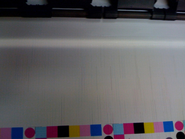

Im having problems with my Mutoh valuejet 2606. IT leaves vertical lines all over the print. Sometimes its really bad but it comes and goes. I can print fine on uni directional. Picture link below is the worst its been.
In order to try and solve the problem we have already replaced the timing fence, head cables, x axis motor, and new heads.
Any help would be appreciated, any further questions are welcomed.

The y axis encoder has been cleaned and the x axis (what i have been calling the timing fence) has recently been replaced.
I was getting a lot of error 72's and after cleaning the circular y axis encoder the problem stopped. Do you think this could be related? I think its probably the only thing that hasn't been replace on this printer.
pjs321
Its strange how it only prints the lines on the bi direction function. It even prints the lines before it starts any print (over white space before a print) and its all 6 available colours. No lines are printed at all on uni direction.

Does it print the lines on the return pass in bi-directional or in both passes? Also when you say that you are changing it from bidirectional to unidirectional what print modes are you using? Some print modes change carriage speed not just unidirectional and bidirectional and this could explain why it is in one and not another. Just so I am on the same page, I think that you have the X and Y axis reversed in your above posts, the X Axis is the media movement and the Y Axis is the Carriage movement. So you replaced the circular disc on the left hand side of the printer correct? From what I see in the picture it would most likely be an issue with the Y Axis, carriage movement. Have you tried to replace the CR cables? These are the cables from the main board up to the carriage board. Error 72 indicates that there is an issue with the feedback from the Y Encoder Sensor; this could be caused by any number of issues. One thing you can check is that there is grease on your bearing raceways and that the bearings themselves haven’t begun to fail. If they have started to fail they can cause vibration in the carriage that causes the heads to fire and would also cause error 72s because there is extra resistance on the Y Motor. If you haven’t greased them or haven’t done it in a while try to apply a light coating of the Mutoh grease and see if this helps. If it does you will probably eventually have to replace the carriage and the bearing raceways.

The lines are printed on both passes. Print modes are high quality 700 and high quality 700 uni
As per your description i have mixed the x and y axis. The fence the carriage runs across has been replaced and not the circular encoder.
I have replaced the cables that go directly from the heads to the board within the carriage and i have also replaced the bearings. I have been cleaning the 2 bearing raceways and greasing religiously to little effect.
So that leaves the CR cables if those are not the cables i have already replaced?

it could be caused by the head cables, t-fence or even CR_ENCODER SENSOR (the sensor could be giving/reading false data) Try cleaning the sensor with some canned air. Make sure there is no dust or hairs on or around the encoder sensor. (It's that black "u" shaped device that straddles the t-fence(encoder).
I would not have changed the motor by the way.....it is not possible for a bad motor to cause a head to miss-fire.
ALSO: make sure the cable from the computer/network is solid and not damaged or having issues. Try replacing it with a new cable or connecting (with a new cable) directly to the printer. Try to eliminate the cheap and simple stuff first. :)
If that does not resolve this consider replacing the CR BOARD (On the carriage) next.
After that were looking at:
1.) Power supply board. (bad voltage can easily cause this)
or
2.) Head Board
3.) CR CABLES (Might have a short in them)
4.) Main Board
But let's hope it doesn't come to all that. It's likely a power spike may have cause a short in any/all of the above that I listed. But I would recommend the client keep the printer plugged into a power strip with surge protection. Maybe even move it off a circuit that may be shared with other high draw equipment.

I have just been told that the circuit im plugged into is not very good and has been fluctuating a lot. So it seems that could well be the problem. We are going to isolate the power supply and go from there. Many thanks for all the help. I will post how things go.
