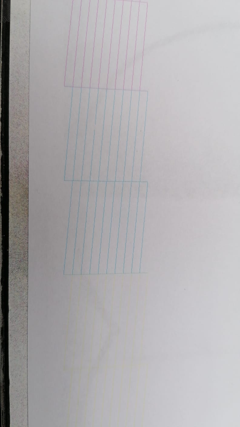

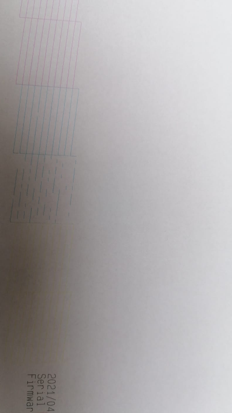

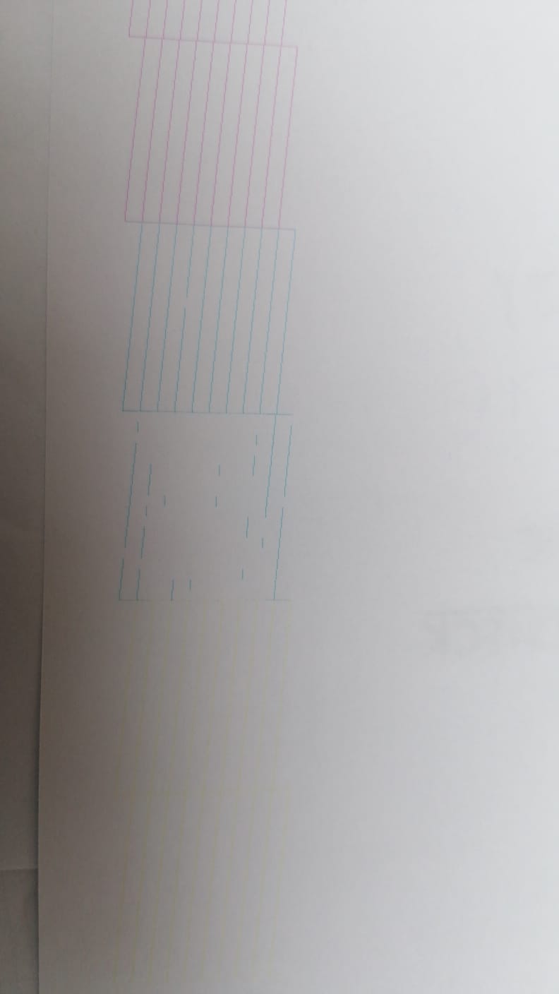

Hello,
I have a printer Mutoh Valuejet 426uf and recently I changed the printhead, after this I have a big issue with one Cyan color only, the nozzle check sometimes is 100% perfect on it and if I shake all the cartridges when the printer ask for it, all the color remain perfect on nozzle check but that cyan is between 0% and 30% at nozzle check... I make every time short/normal or long cleaning but he will correct to maximum 50% of nozzle check.
I changed the cyan with a new one
I swap with the other cyan from the printer
I checked and the cyan is not out of date..
The technical guys did'nt gave me a solution, all solution from them doesn't work.
They told me : When the printer ask for shake all the cartridges to took out the cartridge only 1-2mm outside only for the printer to know that I took out that cartride, they told me to do this to do not let the air to enter in the printer, I tried this and it was the same! The same amount of missing lines of that cyan.
Someone had this issue with his printer ?

Hello,
Are you using 220ml cartridges or the 800ml ink bags?
henryp
I see! Make sure you cartridge is not expired, if is is in date, you may have a faulty valve damper for the Cyan. Were the valve dampers replaced when you changed the printhead? If so, were they genuine Mutoh parts?
