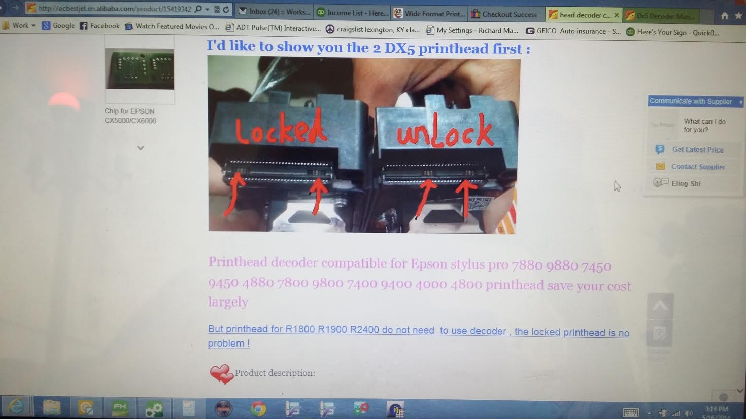

Sounds like your printer has a "locked" DX5 head that's intended for a desktop printer. If the head is printing OK, except for the streaks, then you might be able to keep the head and use a decoder or decrypter card to get rid of the streak. A decoder is a circuit board that you install between the head board and the print head. You would need to know the part number of your Epson head and you need to know if your head is locked once or more than once in order to get the right decoder. The newest desktop heads are locked more than once. And, I don't know how to visually tell the difference between locked once and locked more than once. Maybe some one here knows the difference. From what I've seen online, these decoders cost between $75 and $200. A new head will cost you at lease $1500. I have the same model printer that you have. The Mutoh part number for the head in my printer is DF-49684. I have attached a picture showing the difference between a locked and an unlocked DX5 head.

That's awesome news. At least I have hope for a cheaper fix. And thanks for the part number that helps a ton now I will be able to verify I actually have the wrong head and not some other issue
