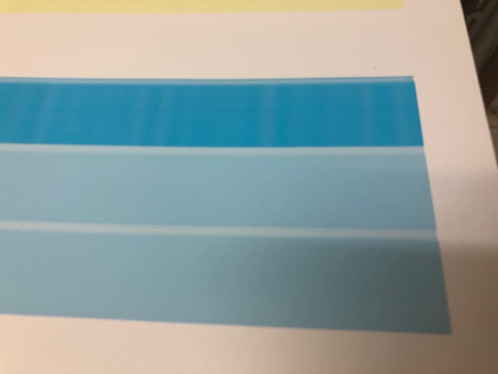

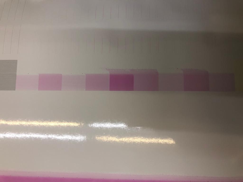

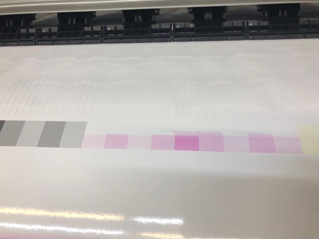

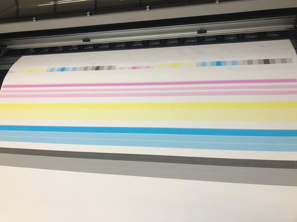

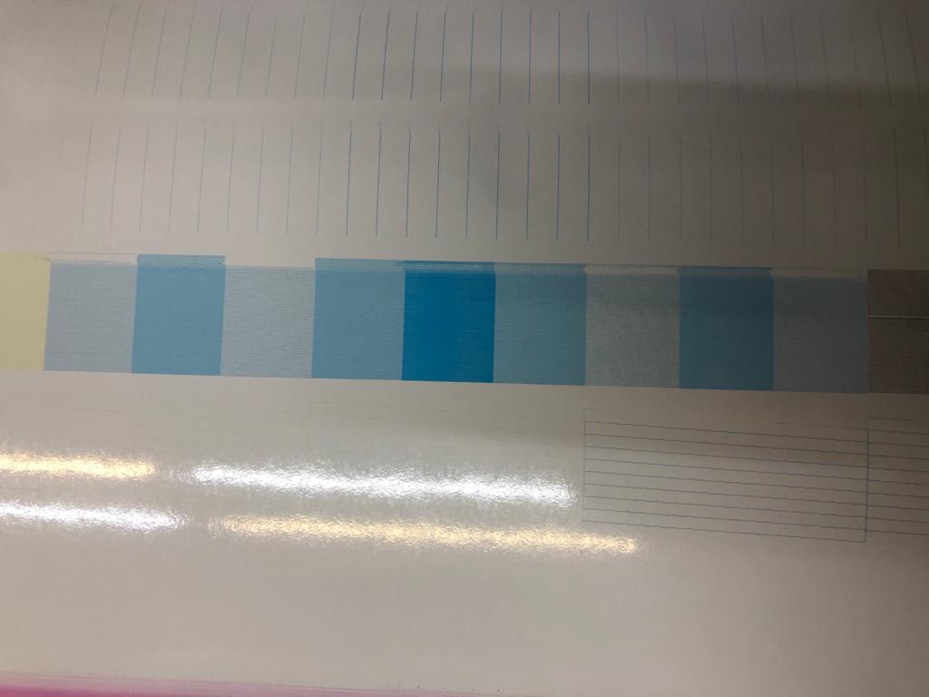

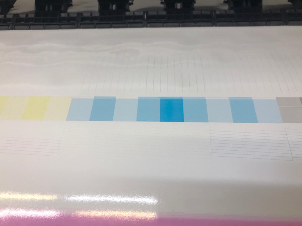

It seems that magenta and cyan have some clogged nozzles. When printing the magenta starts fine for about 1inch then it starts banding. Cyan its almost not noticiable. Ive noticed some magenta sprayed ink in the plate at both sides, also theres magenta spray in the printed image (when using magenta).
In the media attached, if you see the pictures you can notice how some seems to be clogged while others the ink spray at the side.
