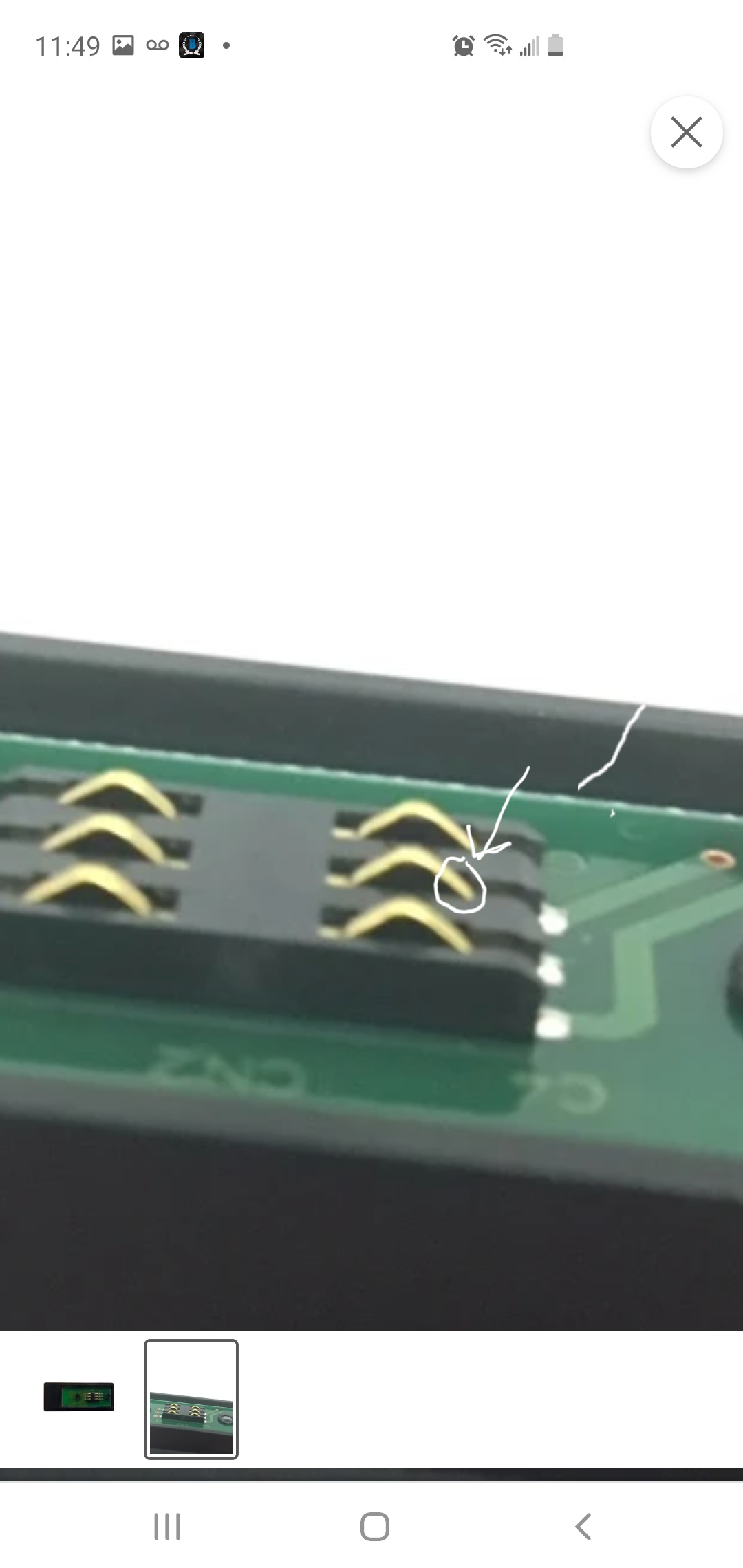

I did look down into the chip id board and the one pin is actually sticking out.

Here's an photo to show where the damaged pin is on my chip. Its actually sticking up instead of being down like the other end of pin.

Listen, go and check all your ink id boards, and then put back the ones that you know for sure that they are good, and leave the other empty, turn up your machine, and plug the cartridges into there slots with a new chip cards if you have new ones, after that check if the chip cards are being recognized on the slots where the ink id boards are present.
Note: You have to know that there are two sensors on the cartridge slot, the one that detects the presence of the cartridge, and the second is the ink id board, if the printer detects the cartridge and can't read the chips card you get read error, and if the printer doesn't detect the cartridge the printer pop up the (no cartridge message) because this is the first condition to verify before checking whether the chip card is good or not.
Also to avoid any short-circuit, make sure to discharge your printer's capacitors before doing anything by pressing the printer's power button after unplugging the power cables.
