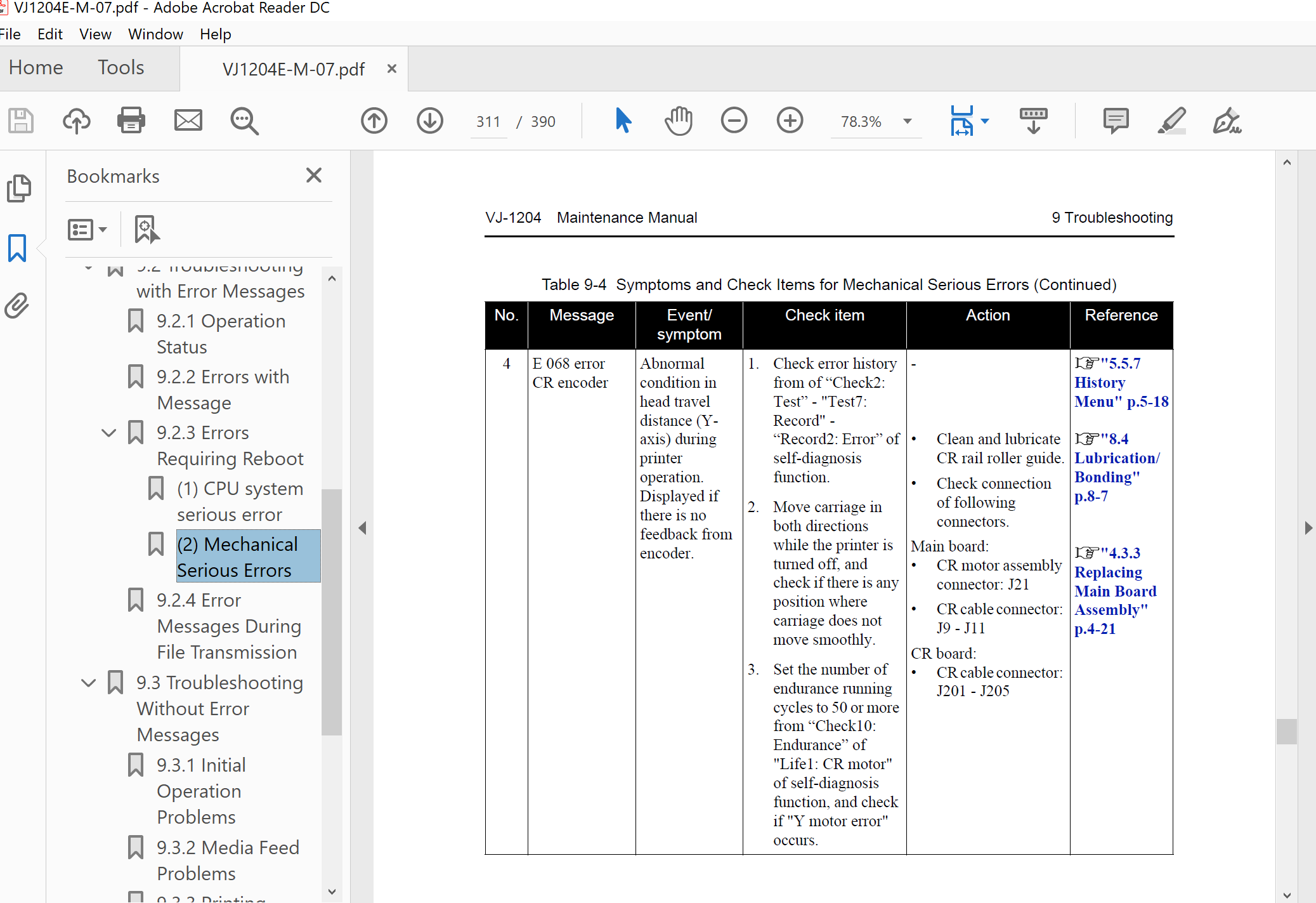

It seems you have replaced just about everything to fix this error as per attached troubleshooting guide
