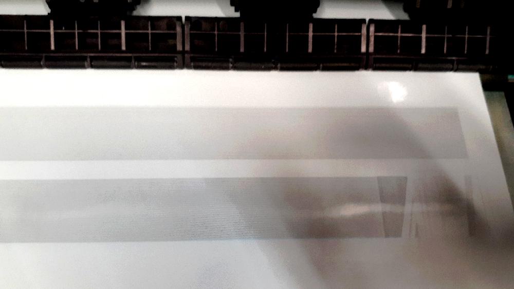

Mutoh VJ1204 Everything is perfect except the one section. Done everything except new print head. Would appreciate any suggestions before I start throwing more money at it. Thanks!

Usually when only 1 channel fails on that model, it's a bad damper or a broken manifold. When you changed the dampers did you also change the o-rings? If not, I would start there. Also, inspect the nipple where the damper connects to the head and make sure it's not cracked or damaged in any way. The manifold is replaceable and a lot less expensive! A good way to troubleshoot is to simply swap the black damper's positions, run a cleaning cycle and then another test print. If the channel that wasn't printing before still isn't printing, most likely your head is fried. If the problem moves however, it could be an air leak or plumbing issue above the head that is causing the issue. It could also just be clogged in which case a good head soak and strong cleaning should help if not a full on manual flush with a syringe.

Thanks for the reply! Switched dampers. Still the same problem in the same spot. I've tried soaking and flushing the head with little to no change. Immediately after soaking, It prints better, and I get about 80% of that section back, but it almost immediately degrades on the next test.

Replaced the print head. This is what I got for my first nozzle checks - nothing else changed.

Victory! Removed the cables from the head, gently scraped them with a razor blade, reinserted them and she's now printing like the day she was born! Not sure what the problem was, didn't see anything come off of them, but there must have been a contaminant of some sort.
