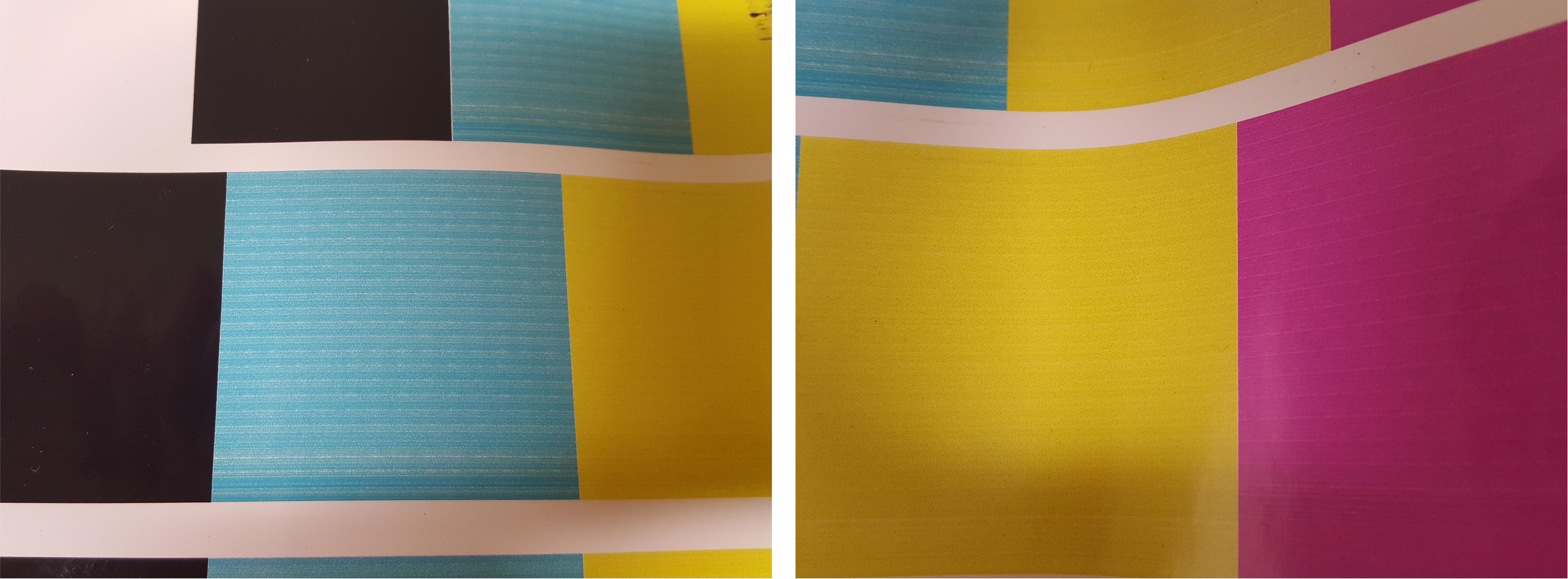

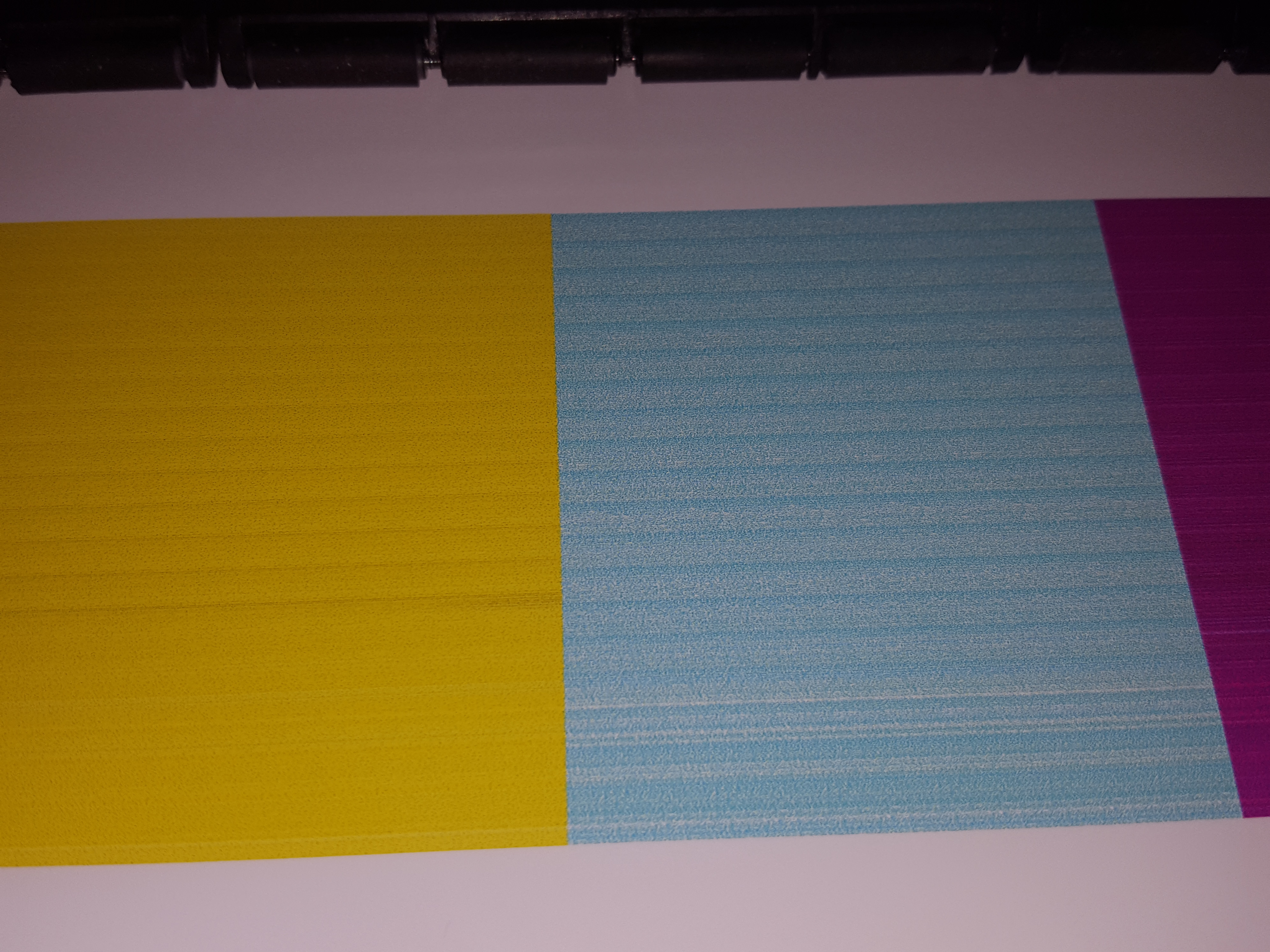

Need Help mutoh vj1204 printing lines in the print how do you fix it
scott dunacn
adgrafix
20190522_173013.jpg mutoh vj1204 printing lines in the print help how do you fix this?
RG
It should help if you clean the long encoder strip that's on top, above the platen. Also, be sure to clean the round (disk shaped) encoder that is inside the left-side cover.
