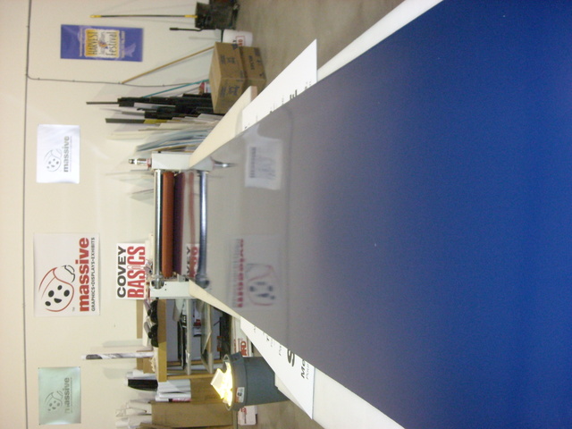

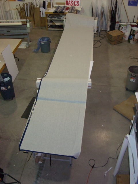

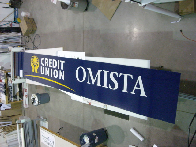

Just finished apply the largest single piece of vinyl I have ever done by hand. 39.5" x 24'
here's a few pictures.. sorry I was to lazy to rotate

I didn't use the laminatot because It's applied to 3/16" Lexan.. the shop is only about 32' long do there would have been alot of moving around to do. Plus thats alot to ask the laminator to do, would have been a strain on the motors trying to push over 100lbs of lexan. Also it's not printed because that blue matched their Pantone almost perfectly and the lettering is reflective.
